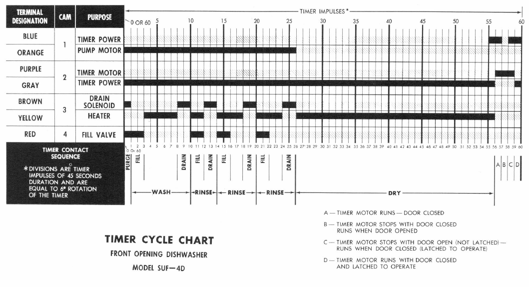

Westinghouse SUF-4D had a main wash time of only 4 minutes. Is this real? Did such a thing even exist and if so how was it even put to market?

Did this machine actually clean? I've never heard or seen of such. I purposefully don't count the first 60-90 seconds of a fill as the water pressure isn't strong enough and the pump pulls in air- but technically you are correct the 90 second fill is part of the wash sequence. By the time the pump pressure is strong enough and the detergent is dissolved thats only about 4 minutes. That is just bonkers lol! I notice the higher end models had longer main wash times and/or a thermal hold. I never liked the fact they reserved realistic main wash times for high end models. Very unfair and I've always felt this bordered on criminal. So many companies did this and all it did was punish people who had common sense and/or were less privileged, kept people down, increased cost, wasted energy, wasted detergent, ruined the environment.
Personally I would not have used a purge but rather extended the main wash time such that cool water could be heated to at least 140*F. Even with piping hot water a purge is unrealistic- the tub, dishes, pots, pans and the like would still pull the temperature down significantly. A purge could flush any detergent which fell to the bottom of the machine ending up in the purging water stream, grate or sump. A detergent pod or tablet would dissolve and be flushed away if it fell into any one of those areas. A 90 second drain (like Maytag) would have been a better solution, but even that gives me qualms lol.

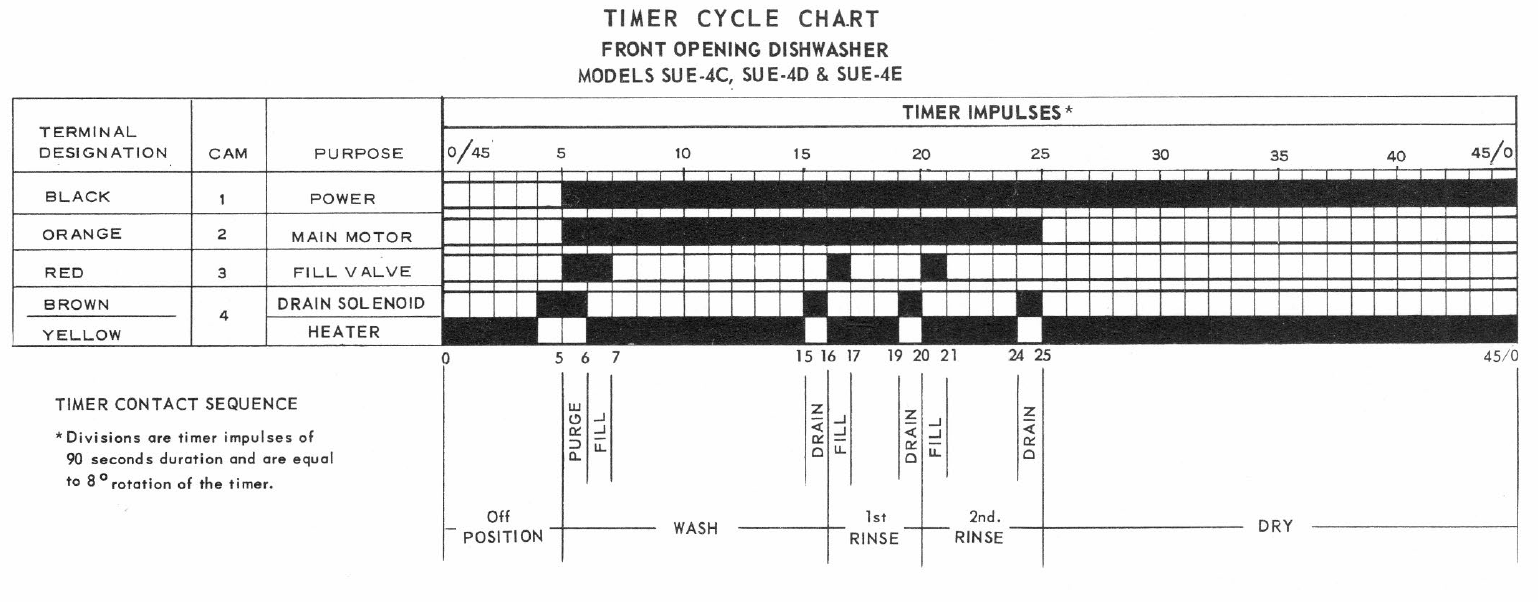

@steve- do you know anything about this model? Was it a latter model? Did the water charge change? 12 minute main wash is more realistic and on par with the day.

Water Usage
11.25 gallons of water total would mean 2.5 gallons per water charge and 1.25 gallons for the purge. Not bad, not bad. A Power Clean had a water charge of around 2.2 gallons IIRC.
Any idea why they then went to two post main wash rinses? Did they just increase the water charge to 3.75 gallons per fill? Or they did find a way to get away with one rinse?
