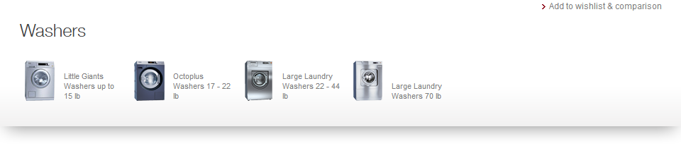

Miele?
https://www.mieleusa.com/professional/washers-390.htm
