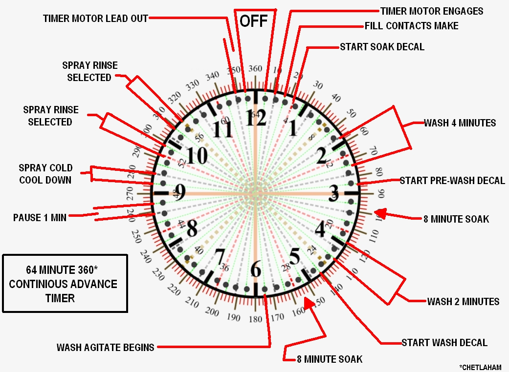

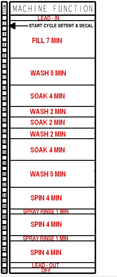

Peirre, this is what I came up with from your screen shot. Chances are that Inglis washer has an incremental advance timer. Re-imagining it as a continuous advance 64 minute timer comes out promising. So here is this:
What do you think? Yay or ney?
Cycle from pre-soak is as follows for Jerome-
6 minutes fill
Wash 4 minutes
Soak 8 minutes
Wash 2 minutes
Soak 8 minutes
Wash 15 minutes
pause 1 minute
Spin 2 minutes
Spray Cool Down 1 minute
Spin 2 minutes
Spray warm or cold 1 minute
Spin 2 minutes
Spin 6 minutes
Motor off and lead out 1 minute

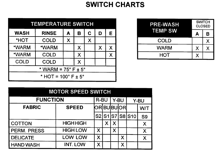

DaDoES, you have a point. I've read a lot of lid instructions and washer manuals that state soaking in hot can set certain stains. Whirlpool's super wash does most likely have dirt in mind vs stains, hence the short time and half tub drain.
I guess I need to come up with a new name for the idea that I have in mind.
I'm curious as well. Did these Kenmore default to warm or drain the water out?
Reply #28
Chet if I select Hot/Cold or Hot/Warm while using the soak&Wash feature on the 1974 Kenmore 70 it will do the presoak and prewash in cooler water and then change over to Hot when it fills for the 14 minute wash.
Neat! Is the wiring diagram still intact on the back access panel on your 1974 Kenmore 70?
If Whirlpool went through the trouble of configuring their machines to fill with warm water on pre-soak when set to hot/cold or hot/warm, then I definitely should not be soaking things in hot water.
