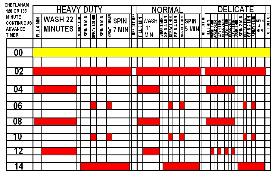

Personally I think that Maytag should never have built a single Norge, Herein, or Performa platform. Just stick those names on the Maytag Dependable care line. Do a slant front lid, various stainless steal and porcelain tubs, BOL and TOL, various control panel styles, dual action agis, ect but never ruin your reputation with cheap, leaky products.
With a spray rinse system like shown below (the 1:30 second warm spray rinses are for you Sean!), Maytag could have kept the Dependable Care line into production until the late 2010s.
Of note, the actual fill duration isn't 6 minutes, the fascia marks are about 2 minutes in, making the fill period about 4 minutes before the start of agitation. The long periods are to take slight decal errors into account and to make sure all the correct contacts are fully advanced forward into a closed state. All cycles have ~1 minute lead in buffer and ~ 1 minute lead out buffer assuring timer contact 02 is always the first to close and the last to drop open. A 1 minute soak period between agitate and spin assures timer contact 12 is fully dropped open before contact 14 is allowed to rise into close. OFF increments are 2 minutes long in the 120 minute timer and 7 minutes long in the 135 minute timer.
