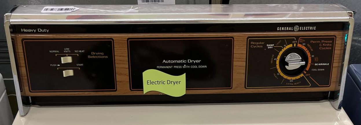

This is my all time favorite dryer- DDE5300BAL. A true long life no nonsense workhorse with a very elegantly designed electrical system.
img.axd
A true ideal dream dryer would be the same cycle concept and double heaters but in a Whirlpool top filter version with hamper door, drum light, beefed up frame, rollers, belt and idlers.

Sean, its actually two heating elements. Normal heat runs both, knits runs one of them. The concept is elegant and to my tastes.
Execution was poor however. The elements do fail exactly as you mention, and I've seen hair pins and wire clothes hangers poke through the drum holes and tear the elements off their supports into a coiled ball at the apartment scrap pile.
On the flip side, these dryers lasted and lasted when taken care of. You also got a real 130 minute none temperature graded normal cycle with a 5 minute cool down.
