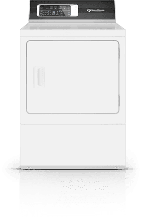

hello to all would love to have advice from speed queen expert to convince my mom when the time comes or if duet washer dryer set is beyond repair to convince my mom to switch to speed queen washer dryer set my mom wents to stick to front load but in canada they only have the top load model and went to convince my mom to consider we switch back to a top load this is the model i have in mind
https://ca.huebsch.com/products/home-products/top-load-washers/tr7/
https://ca.huebsch.com/products/home-products/dryers/dr7/
plus since i had exema and my skin is sensitive to strong sent i think it woulkd remove more detergent if we went back to a conventinal top load and clothes would smell less like the detergent sent after the wash plus aspecaly with a cat its important that pet hair be efficently remove plus i like the fact that i can manualy select water level on the washer plus also like the warm rinse option if i need to do a warm wash warm rinse plus i also like the soak and pre wash option can be done with the main wash i know its long term but it needs to be tough of snce curent set is 16 years old and love the fact that its 7 year warrenty rather than just one compared to other brand of washer dryers thank you for all the good advice
I would recommend the SQ TC5 over TR series
I would watch videos specifically from Lorain Furniture and Kirk Rivas. There are some other good videos too, but these two do reviews on several brands of washers.
Both SQ top loads will wash office wear and slightly soiled clothes well. However, the TC5's wash action will work better for workwear, sports uniforms, gym outfits, etc. It's wash action will also turn over and wash a bulkier item like a comforter better. The TC5 classic design may not have as many features, but sometimes less is more especially when it comes to reliability. Less is more is one of the reasons I opted for the most simple top load I could find.
