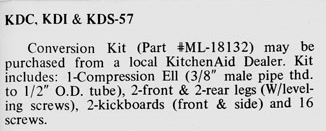

<span style="font-family: verdana,geneva;">The machine in the picture is a 56 Series Portable.  I have a 57 Series portable that does require a conversion kit.  When I purchased mine the wheels and bottom portion was damaged in shipping.  I wanted to use it a built in anyway so I wasn't too concerned but when I got under the covers I discovered it couldn't be converted without the kit.  I just don't know if the 56 and 57 models were the same in this regard.</span>

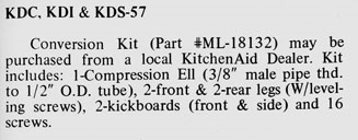

<span style="font-family: verdana,geneva;">Unfortunately its not just a matter of the leveling feet.  The machine does not have the legs to screw the feet into.  They are included in the kit.  I attached a copy of the instructions and it states what is included in the kit.</span>

<span style="font-family: verdana,geneva;">I was really eager to build it in but without the legs it would be impossible.  When you take the base off the bottom the motor extends beyond the end of the side panel so you have to set it on something which is why I made the cart.</span>
I know you know a lot about these machines.
<span style="font-family: verdana,geneva;">The only thing I can figure out is we are talking about two different machines.  I have a KDI-57.  I have been under the machine and I can assure you there are no legs.  The documentation on the conversion kit clearly states it includes the legs and shows pictures of how and where to attach them.</span>
<span style="font-family: verdana,geneva;">The model he was looking at is a 16 series so I don't know if his is the same as mine or not but the bottom of his looks the same as mine.  It seems like a moot point since he is looking at a Superba Built In.</span>
<span style="font-family: verdana,geneva;">If the legs were available separately I sure wish  I could find a set.  I didn't notice them on the parts lists I have.</span>
