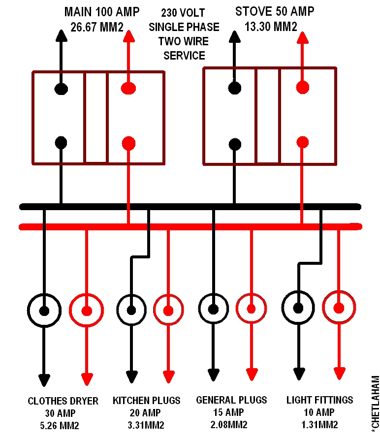

With that said, I have this strange dream where I could wire an old house like this but with 230 volt circuits, double insulated appliances and none metallic sheathed cable adapted to vintage based wiring devices.
How I imagine the fuse box in another reality:
