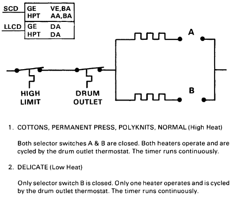

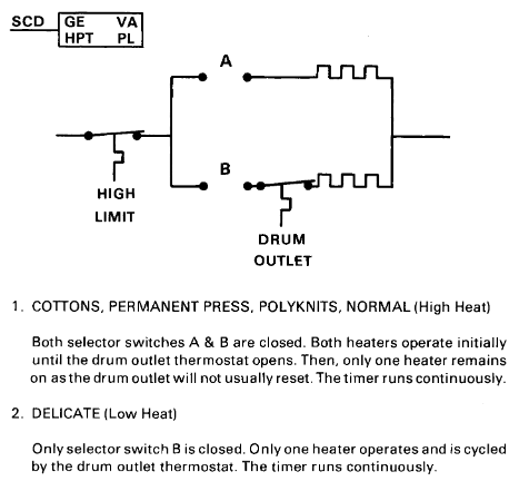

What is the difference between GE VA and a GE VE, BA and DA models? Why does one set have the drum outlet stat in series with one heater while other model platforms have the drum outlet stat in series with both heaters? Whats the point of opening the cycling stat and keeping it open in some models?
