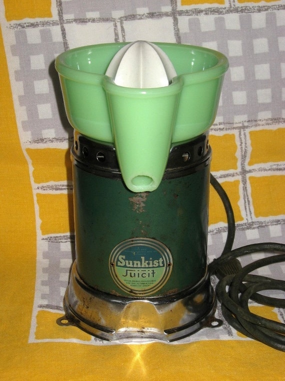

Just bought a 1930's-1950's Sunkist Juicit juicer with green jadite bowl but need the reamer part,plus a slide type switch. The reamer part fits on the male hex shaft of the juicer. I removed the old cord which was brittle,dry & cracked after removing two screws on top ,two screws on the side then bending three metal tabs to remove the bottom cover to remove the motor. I then bent back the metal tabs that secure the cord in place & cut off the wires of the cord & cut the wires from the old switch. Once I get the new plug,switch & cord,I need to do soldering,I hate soldering because I tend to mess things up doing so. I included a pic of the juicer because mine exactly looks like it.
