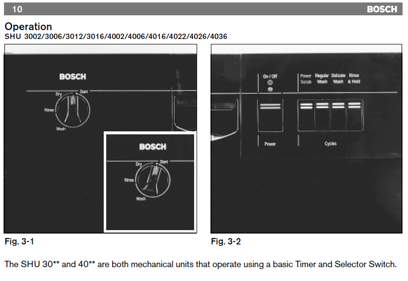

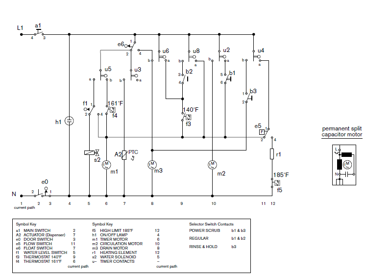

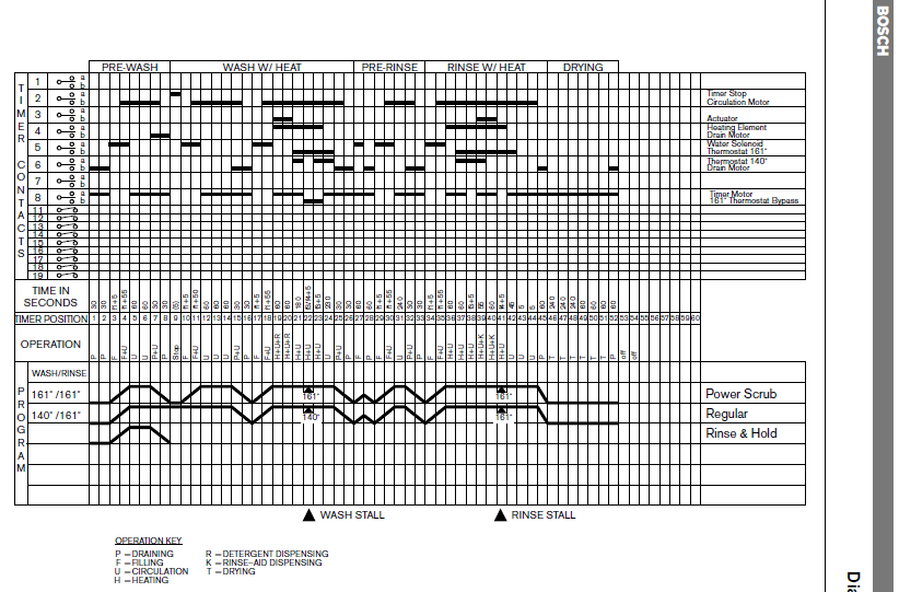

Sounds nice, but far to complicated for my taste. I like the EM SHU series from 1998. They breezed right through with a single speed motor and offered 161*F final rinse temps.  Prewash-Rinse-Main Wash-Purge-Rinse-Final Rinse. They were simple, quiet and great machines. No electronics. Reasonable cycle times. They offered a Kenmore version too. How I miss these Bosch machines. The knob is like that of a Potscrubber.
