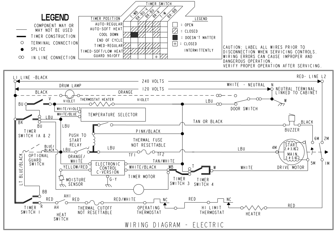

What did Kenmore mean when they listed "soft heat" on their control panels? Is this some type of feature, electronic control or a lower thermostat setting? I always like the emblem.

Ok, so it seems like earlier models used either a modulating gas valve or multiple heating elements which maintained a relatively even exhaust temperature. While latter models switched on their bias heater for low heat 10-15 minutes before the cool down.
Neat.
My Maytag Centennial dryer does this, it will switch on low heat before the cool down. The concept doesn't work well with heavy loads, though it is what it is.
Maytag Dryer MEDC300XW0
Confirming- looking at my Maytag dryer it seems like it also has soft heat. Contact BU-V is labelled as "soft heat" and closes about 10 minutes before the cool down in both the timed dry and sensor dry cycles by energizing the thermostat bias heater in full.
I guess the answer was in front of me all along yet somehow I never made the connection that the dryer switching to low heat before the cool down for a type of soft heat.
Personally I don't like the concept, at least not in the way its being used/offered, in that my dryer does not have a normal cycle offering a 130 minute timed dry. 70 minutes with 10 minutes of low heat followed by a 10 minute cool down does not work well with heavy denim or towel loads on medium heat. I personally like medium heat all the way through with a 5 minute cool down for regular loads.
GE uses a similar concept with two heating elements, though their design relies on the temperate of the heater housing ("drum inlet") and not the exhaust itself. I've noticed GE's concept cutouts way to soon in the load leaving only one heater running throughout most of the dry cycle. I wonder if that has something to do with reduced air flow in that GE dryers were built to run at 120 volts at one point.
