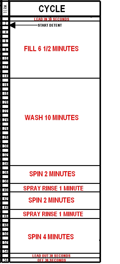

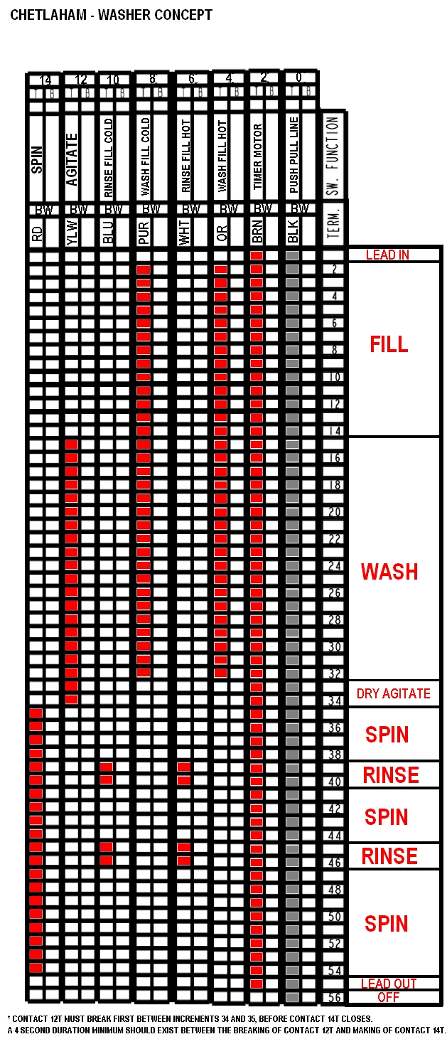

What Whirlpool's Controls Ought To Look Like
This is what people should be demanding and voting on from any appliance maker, in a metal Eaton or metal MTS style timer.
Perhaps contacts 12T and 14T would better suffice as drop on and lift off instead of drop off and lift on due to the motor making inrush, but that is an easy swap. 30 second increments btw- though 1 minute at 48 7.5 degree steps would be a better timer alternative.
From MTS's website:
Timers
Before anyone jumps on me for the spin or wash being to short, this is just one timer meant for a very BOL machine. The idea is to demonstrate the sheer amount of simplicity that could be built into a washing machine while being complemented with very over engineered parts and numerous overlapping fail safes.
