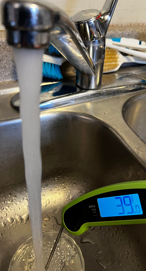

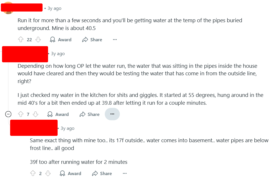

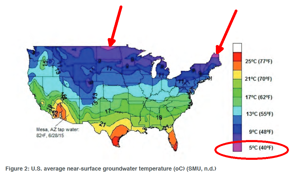

William, just have a look at Launderess's link. And when you factor in other variables, water can easily drop to 40*F under worse case scenarios. Not sure where this zeal comes from to prove me wrong when most everything I say can be verified by a few mouse clicks.
Not my pic, but it proves my point and my lived experience-
 Just because 40*F isn't the mean or median average across the nation doesn't mean it doesn't happen in some parts of the country. For the sake of discussion these consumers would benefit the most from hot tempering.
Jerome, forget ATC. William and the 3 upvoters who agree with him are saying tap water can't reach 40*F. I am now opening some science books for the first time in my life while denouncing all my past memories. Oh, how could I have let myself be deprived of this beautiful  knowledge for so long?

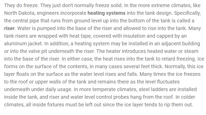

Right. Now factor in water being delivered from open lakes and reservoirs out in the open, 100,000 gallon unheated water storage tanks, exposed piping at regulating and pumping stations, unheated manholes, ect. The frost line is only part of the equation.
As long as the water keeps flowing it won't freeze.
Nobody is going to waste energy heating millions of gallons of water per day to match temperatures at 30 feet below grade.
Water Towers Often Contain Ice
Water towers themselves rely primarily on water movement and are only heated just barely enough so they don't freeze 100% through. Water towers can and do contain solid ice in cold climates. As long as the tower does not become 100% ice, its common, acceptable and economical to have solid chunks of ice in addition to liquid water inside a water tower. Water being added, removed and re-circulated is what prevents the ice from becoming to thick. But it is still present in appreciable amounts chilling newly added water.
Water tower levels rise during periods of low demand, and then fall as demand peaks.
With many people drawing water at once during peak periods water doesn't have enough time to sit around in underground pipes to reach equilibrium with the surrounding earth temperature. So instead water has a tendency to take the temperature of the chilled tower and its exposed piping.
Again, its not economical to heat this water to 50*F or remove all ice where it forms.

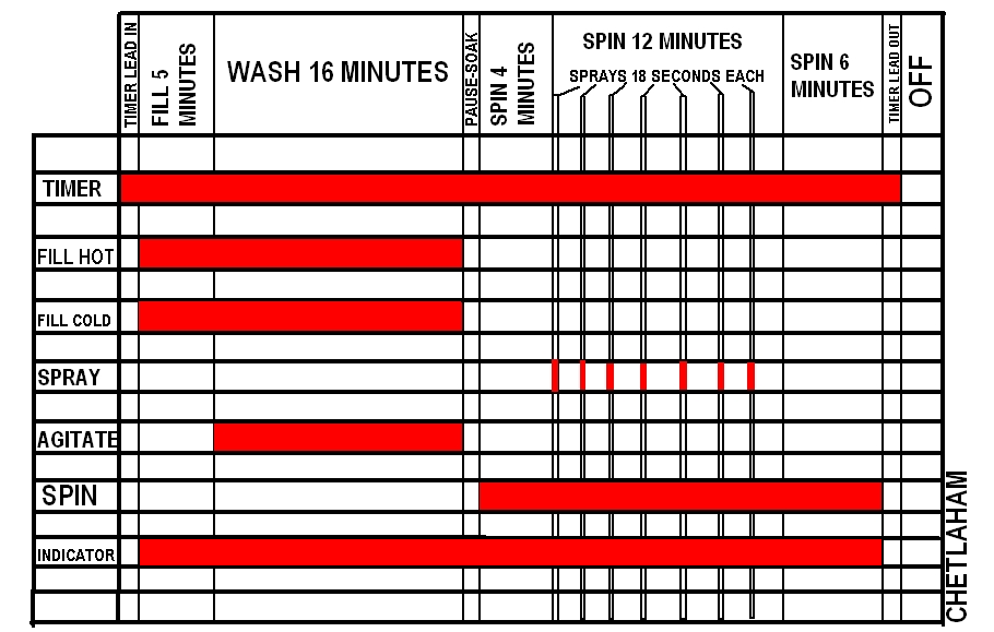

I personally prefer a warm rinse in the winter. I think the reason you're getting less suds on winter cold is because the fabric isn't relaxed enough to release the extra carry over water from the wash. Though, in theory, that might be less of an issue because the resource saver forces water through the clothes while allowing them to absorb and then release water each spray cycle.
I wouldn't mind having such a washer, or at least one that used a series of spray rinses instead of a deep rinse. The final two sprays could be warm to make the fabric more comfortable out of the wash and to speed up drying. Spray rinsing would simplify top load washers a good deal and save a lot of energy in relation to warm rinsing.
