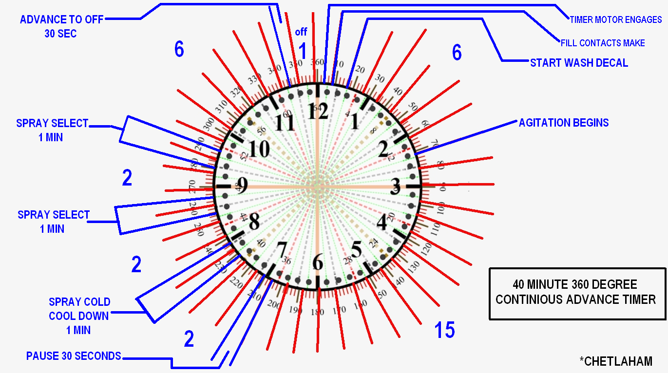

What is the total advance time in minutes for a full 360* revolution on these single cycle timers? The time it takes to go from the 12 o'clock position back to the 12 o'clock position. Was it 30 minutes? 36? 40? Any service excerpts?
Here is a cycle concept with a 30 minute 360* revolution timer. Each dash represents 30 seconds passed.
Fill = 6 minutes
Agitate = 10 minutes
Pause = 30 seconds
Spin = 2 minutes
Spray = 1 minute
Spin =  2 minutes
Spray = 1  minute
Spin = 4 minutes
Advance to off  = 30 seconds

Jerome, I made a cycle for a GE filter flo though it might need an extra two minutes for the fill time- filter flos take around 7 minutes to fill vs 5 on average. Fill flume angled into the tub for 100% inward basket spray delivery. This cycle can also work for a direct drive.
It takes advantage of a 40 minute timer. To be honest I think this is ideal more or less. Lots of symmetry in the cycle including a 1 minute off period after the 30 second to off advance after the final spin which would be highlighted so on the control facia, 30 seconds until the timer contact engages from the off decal period, 30 seconds latter the fill contacts would engage, 1 minute latter the dial would point to the "start cycle" decal if the timer motor was made to advance continuously through the off period which it wouldn't of course in normal operation.
So anyways, the cycle:
Fill 6 minutes
Agitate 15 minutes
Pause 30 seconds
Spin 2 minutes
Spray Cold (cool down) 1 minute
Spin 2 minutes
Spray select 1 minute
Spin 2 minutes
Spin 6 minutes
Advance to off 30 seconds
