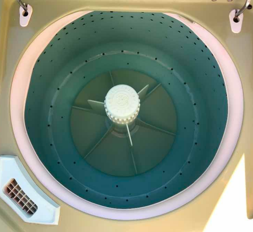

What is the deal with semi solid tub washers? I noticed GE and Hotpint would do this thing where they had two rows of holes at the top and a row at the bottom of the basket but little to nothing in between. Does anyone know the reasoning behind this?

Maybe I'm looking into it to much, but I feel like GE knew something by going with this type of  wash basket perforation design.
Personally I think this design is ideal for spray rinsing. During a spray rinse, water often hits the lower half of the garment load. By placing most of the holes at the top of the basket, rinse water is forced up through the cloth load, out the top row of holes, onto the outer tub, then that water runs down the outer tub walls and down to the drain orifice. Like this the whole machine, including cloths, are rinsed thoroughly.

would saturate clothes, spin out the excess residual water, then re-saturate them 4 or 5 times gradually diluting the small amount of remaining residual water each time mimicking a font load rinse sequence. Even perforations would cause water to go straight through the garments where the water flume hits the fabric, mostly missing the upper band of fabric.

Chet you’re not paying attention. This has been discussed at length GE made this change to reduce the amount of sediment and streaking that can occur in dark clothing because of lint and mineral residue when the machine struggles to drain and spin at the same time.
All spin drain top load washers ever made had this problem to some degree, even neutral drain whirlpool washers, have it to a very slight degree, but it’s almost never visible on a neutral drain machine.
Only front load washers escape this problem completely because of the way they tumble and drain.

Redeposited Lint and scum during spin cycles
Hi Patrick reply number nine you are correct you’re probably also aware that Speed Queen traditional washers that are sold in Canada and Australia, etc. are built with neutral drain because of the problem of red depositing lint, it’s more of a problem in countries where people don’t use clothes dryers for everything.

Hi Patrick, obviously it’s a lot worse when water keeps slashing over the top of the tub as it tries to drain because the dirty water is strained through the clean clothing over and over again.
But you still get the effect when you spin a tub full of clothing and water because the clothing tends to go to the outside and the dirty water is forced through the clothing, so you still have this effect in any top load washer that spins the water out of the clothing the clothing tends to turn into a filter.

When Maytag started selling top load washers that were made by Norge, they even said in the advertising literature that your clothing would be cleaner and brighter than their previous dependable care machine machines because the Norge design machines had such a powerful pump that the water was pumped away more quickly and the hole design in the tub plus the slow acceleration tended to minimize the redepositingof this dirt in the clothing, I don’t make this stuff up. This is straight from Maytag.
