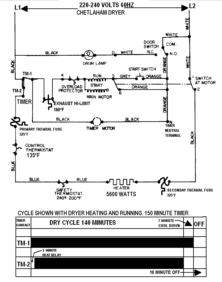

Only thing I don't like about your dryer (respectfully, no offense intended) is how the 1.4kw heaters shuts off on the easy iron (140*F setting). The way I imagine the ideal dryer as shown below is with a single 5,600 watt heating element that cuts out at 135*F and resets at around 115*F. The heater is capable of being energized throughout the whole cycle except for a 7 minute cool down before the cycle finishes. The 7 minute cool down is just long enough to leave the clothes reasonably warm but not hot at the end of the cycle. The 5600 watt heater produces fast results when running but the dryer as a whole never gets above 135*F.
