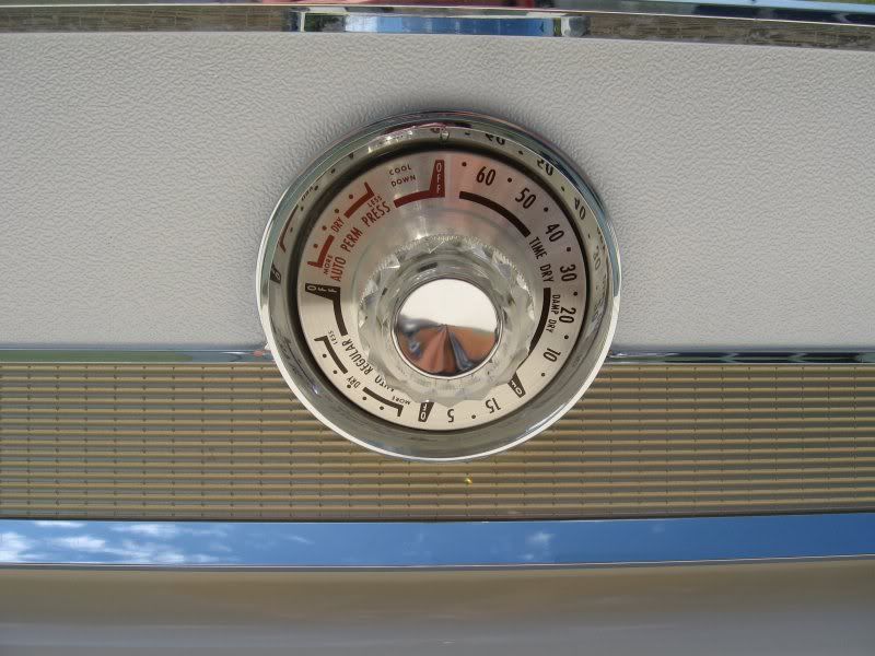

Well, in the daylight then don't look quite as nice. The washer is a bit rough, it has some white streaks from what I suppose was bleach spills? The front service panel on the washer is a bit chipped, it looks like perhaps someone took it off and laid it on a concrete floor or such and bits of sand or something marred it. Body on both of them are straight though, no dents or anything. I may attempt painting the front panel on the washer before I install. And the trim/grill on the washer needs some cleaning, and it has a small crack under the timer. But it's in OK shape considering it's age I suppose.
The dryer though is in really nice condition however. I'm pleased with it.
I think I have the appliance bug now though. These may get replaced somewhere on down the line by something better... Or maybe not, they do remind me of childhood washings. They do look like great workhorses.
Now, pictures!
http://i170.photobucket.com/albums/u274/JamesBondsAAB/012-10.jpg
Matthew:
Nice Dryer! I have the gas 409, which has automatic control. Yours is the timed dry model with the tub light. It is a fine dryer. That series is the best Maytag ever made, in my opinion. Having one is such great shape is even better. The washer is the economy model with the small tub and one speed. It's a little workhorse as well, but for regular use you may want to keep your eyes open for a nice matching almond A408 or 608 washer. You would love the large tub and the flexibilty for washing all kinds of fabrics.
Bobby in Boston
I have a 206 console which is a 2 speed version of what you currently have. You can have for free. I may be able get a 2 speed motor for it this coming weekend.
Bobby, this dryer does have auto dry control regular and perm press fabric cycles as well as timed dry and timed air fluff. I wonder if all dryer temps are "low" or if auto dry regular is high heat and perm press auto dry is low heat. And this is a dial-controlled fabric-matic machine--perm press, regualr, and delicate cycles--just not controlled by buttons like on the 408 and 409.
Oops!
Sorry about misinformation on the dryer. It's the same as the D409 without the temp selector. A fine dryer still!
Bobby in Boston
