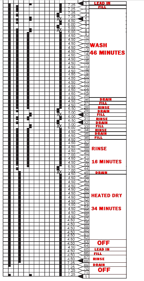

Another thread got me thinking. How necessary are pre-wash cycles with modern dish-washing detergents and longer main wash times? How practical would it be to eliminate the prewash sequence altogether?
I've noticed modern dishwashers in general have fewer pre-wash phases and more post main wash rinses compared to machines 30 years prior.

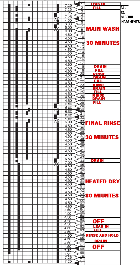

I'm thinking of a cycle sequence like this- either on a modern machine or on a Whirlpool Power Clean Module, Maytag Reverse Rack or a Hobart Kitchen-Aid.
Second Variant:
Main wash, final rinse and heated dry are all heated.
One reason the US tends to be more prewash friendly is hot fills.
You gotta assume most people don't purge lines before starting the DW, so even if a prerinse is cold, that purges the lines making the following main wash more of a hot start.

One cycle on my DW doesn't have a prewash.  It runs wash (105°F), rinse, rinse (105°F), and no dry period.
The heaviest cycle is a prewash and two prerinses, main wash (150°F), three rinses (final 163°F).
