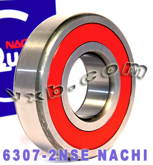

I made the rounds for the last 2 day to various auto shops in the area, scored ZERO bearings.  All had to be ordered in at $$, same with any sort of seal.  I ended up ordering the bearing online, got Japanese sealed bearings, and I bit the bullet and order the seal from the guy in the video.  opted NOT to get bearings from him after reading through is Google group.  A number of people complained that they are cheap Chinese bearings, his comments amounted to s--"So what, that's what WP used...".  I got both for $38 delivered from VXB bearings,
Since I can't find any sort of lead on the seals, I order it from him, $24, but at exorbitant $13 for shipping.  I bought a caliper and found that the metal ring that fits into the bearing on my machine is 50mm and the outside diameter is 100mm, not any thing like many of the seals I see online or mentioned in various posts, perhaps Wp changed the design a few years back,

Well the parts showed up Monday, but had out of town company so I tore into the project today.  I bought sealed Japanese bearings and the seal from the You tube guy.  The seal has CHO- 03283  TC 50 100 10 stamped on it.  It has a solid metal underbody unlike the one it's replacing.  here is a shot of the new set:
