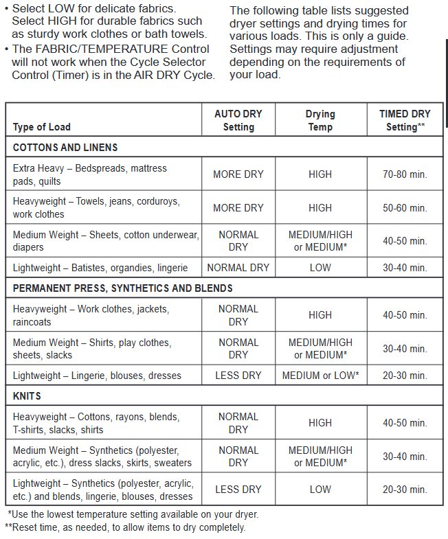

Why do some dryers only offer 50 minutes of timed dry while others offer 70, 80 and still others 90 minutes? How do manufacturers choose what maximum dry time to put on their dials?
I ask because I came across this dry guide from a Kenmore owner's manual:
I notice Towels, Jeans and bedspread dry times are based on a heat setting of high. Does that mean the user should not dry them on medium or delicate? I only use medium heat for towels because I find high to be way to hot. And since the manual recommends resting the time as needed, does that mean its common for clothes to come out of the dryer damp?
https://s3.amazonaws.com/sm-backend-production-attachments/owners-manual-3405586-RevA.pdf
"How do manufacturers choose what maximum dry time to put on their dials?"
I've noticed that lower end dryers usually have a longer timed dry cycle due to more space on the timer dial from lack of options. Just an observation of mine. Usually most people aren't using a timed dry cycle with an auto dry option, especially a sensor auto dry model. Actually, I should rephrase that. The manufacture probably ASSUMES the owner won't use the time dry cycle much. I know a few people who spend big money on a TOL model and use timed dry only 100% of the time.
"I notice Towels, Jeans and bedspread dry times are based on a heat setting of high. Does that mean the user should not dry them on medium or delicate?"
It should be fine, it just takes longer to dry. Delicate would probably take forever on a bedspread and well beyond the maximum allowable time for the timed dry cycle. The cooler heat settings may or may not affect the accuracy of the auto dry cycle. In my experience, some dryers it does, others it doesn't.
"I only use medium heat for towels because I find high to be way to hot."
Should be able to use the combo of "medium" heat along with "more dry" to get the desired results. Gotta play around with it.

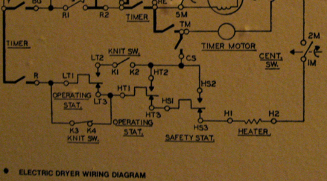

Ok, now I see why the auto dry won't advance. The cycling stat must open first in order to send power back up to the timer. These design did not use a resistor, instead a 3 pole cycling stat. It might not hurt anything to go back to the original hi-limit rating and rely on the cycling stat. The manufacturers have already done the calcs so if you aren't exceeding the OEM high limit and the OEM cycling stat you should be good.
Reply #9
The 160F thermostat I have installed for the high limit is as close as you can get to the original OEM part which was L155-30, the thermostat I have installed is rated for L160-20 which is close. There are a few L155-30 thermostats out there, but have to improvise, 160-20 is close to the stock thermostat.
I did experiment with a L140-10 and L150-20 thermostats, resulted in long, long drying times, auto dry didn’t work as intended since it would be the same dryness regardless since the clothes were dry before the main cycling thermostat was satisfied, cycling only on the high limit. Was fairly quick with the L180-40 thermostat, but the front of the cabinet got too warm for my liking and certainly will shorten the life of the felt seal which prevents items from falling on the heating element and shorting it out.
I see your issue and now understand why you wanted to go with a dropper resistor. Maytag never wired the high-limit into the timer. Whirlpool used a 3 pole high limit, 3 pole delicate and a 3 pole normal stat like below:
That way if any stat tripped for any reason, the timer would advance. IMO not very smart for Maytag to no include the high limit since a clogged vent of failed cycling stat would result in the dryer never shutting off.

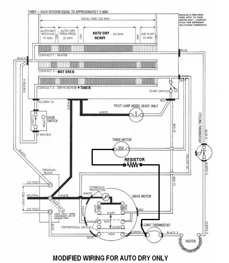

Do you still want the resistive dropper circuit or do you just want to stick to time dry?
Reply #11
Just going to leave it as is at the moment since it’s not broke. With the power dropping resistor, the timer motor would get power regardless of wether the heat was on or off. The resistor was stepping down the voltage since if I advanced the timer manually to the cool down, the timer motor would speed up. Was sort of working, but not working as intended. Since I transferred the glass lense from the 808 console to the 806 dryer console, putting that idea to rest.
Though, I’ll probably need to power dropping resistor for something else since I am going to be transporting a Whirlpool Mark 18 console onto my ‘63 Whirlpool Imperial dryer (also going to transfer a console onto the ‘63 Whirlpool Mark XII washer), will just be a thermostatic auto dry and not a pesky moisture sensor.
Sounds like it was not hooked up right, a contact/jumper was not taken into account within the timer, or you've got a loose connection. With stats closed and the heater running the voltage drop across the circuit should at absolute most be one or two volts. I can't picture 2 volts being able to drive the timer motor.
Sean, if you're willing to trade in timed dry for a super auto dry you can go the following route. As long as the heater contact is a drop off on break (positive shut-off) at the end of the cycle (which most likely it is) and you remember to set the timer with with both the heater and motor contacts engaged at the start of any auto dry cycle- following concept will work flawlessly. You will also retain your cool downs and your air fluff cycle.
The long auto dry cycle has the advantage in that it will compensate for your reduced cycling temperature and take big bulky loads into account both that would otherwise trick the dryer into shutting off early. I've noticed that a lot of dryers, like my previous late 90s GE for example, would always shut off with the clothes still damp when set on auto dry + low heat. Further the timer will run regardless of which thermostat tripped out. An important safety feature.
To get this to work you'll have to move one lead of the timer to the yellow motor contact on the timer, the other lead will need to be unhooked from the neutral terminal of the timer and connect to the resistor. The other side of the resistor will have a wire go down and connect to the green ("4") side of the high limit.
The only down side is you won't be able to adapt the dryer to 120 volts in the future, but that may never be an actual issue.
Wired it up that was as well, didn’t work either. Maybe I’ll look into it in the future, but leaving it as is since it ain’t broke. Guess these older dryers that use a double throw switch thermostat really weren’t designed to use a power dropping resistor.
I’ve literally tried different configurations, anything you can think of, came out with nothing.
Will probably put the power dropping resistor once I customize my Whirlpool dryer, along with my Whirlpool washer sometime this upcoming spring or summer.
