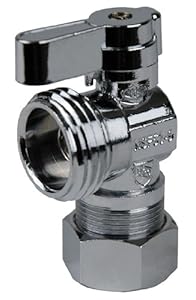

What about something like this?
3/4 in. Bronze Compression Ball Valve with Drain Full-Port
http://www.homedepot.com/p/Apollo-3...alve-with-Drain-Full-Port-THDCWD104/203020073
I'm note sure about the connections and if I need a drain port.
Is this also an option someone was steering me toward?
I'd assume I willl need two.
Any insight here would be apprciated.
thank you
I'd rather have something like the one with the 3/4 ball valve and lever
( Pictured in post above )as it seems more for appliances, while these others are sold as mostly convienence for garden hoses.

Is there someting that will attach like this but is a ball valve with lever like the one I have picure in the previous post with the yellow lever handle(compression one). I am not familiar with the compression connections and assume this is not what I want for ends. However my hoses may have an adaptor in between them and the taps if I take it all apart.
Is there a lever type valve with the standand hose thread connections on each side like the garden hose valve but like the compression valve I have in post above?
It seems better for appliances than one for hoses IMO. :-)
thank you
That compression ball valve is for use on copper pipe.
You just need something simple and inexpensive downstream of valve to relieve the full water pressure on the washer and hoses. If you want something similar but more substantial try hardware or plumbing supply stores.
If I were going to shut off the water after each use I think I'd want something damn simple, like one of these single lever valves from Watts. Granted you have to be a bit handy to install it unlike the simple screw on valves with the Garden Hose fittings. With the shutoff operation being as simple as flipping a lever, I could almost see doing it with one of these.

These are all good ideas. It's a matter of my clearance between the wall and the hot and cold tap. They come out and angle down like a sink tap but with the screw on ends that look like they have a fitting to adapt to the hose type fitting. I have about two inches between the wall and the connections so I could see possbile having a problem attaching the long lever ones without plumbing expertize.
