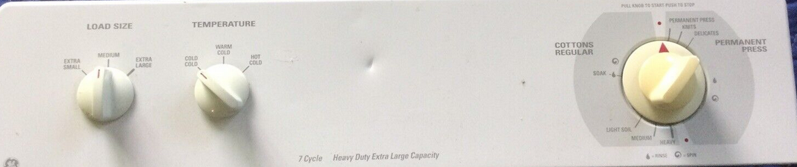

In the past I had a GE washer with a single speed motor that was labelled "delicate". The washer was far from delicate in general. There were no soaks or pauses on delicate and the delicate rinse was longer in agitation time than the Cottons Heavy Cycle. Which got me thinking. Is there a standard as to what a delicate cycle or any particular cycle must conform to? Would it be theoretically possible for someone to successfully litigate GE for false advertising or can a company legally label anything hand-wash/delicate/ Permanent Press/ect entirely on discretion?

GE counted all of these points on their normal cycle dial as individual cycles. I remember wasting a couple of hours one day trying to get the "SOAK" cycle on the dial (a total lie; later they defined it as an "ACTIVATED SOAK". Most of the other brands did the same thing. Maytag didn't back then; one of many reasons I had respect for the company and the product.

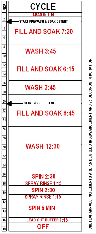

To me a soak cycle in marketing terms is one that either stops automatically after agitation; or fills, agitates, soaks for a period say 20 minutes, then advances to prewash.
Ideally for me a soak cycle fills, agitates, soaks, agitates, soaks then advances to the main wash.

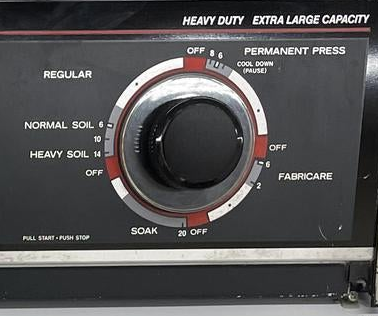

Whirlpool and GE had the best cycle conventions IMO.  I also like the alphabet cycles Whirlpool had where the temperature was built into the letter selected.
Anyways, it seems like Whirlpool was the most hesitant at calling a single speed cycle "delicate" Roper washers for example, despite even having a soak period in there least intensive cycle, would call that cycle "fabricare" instead of "delicate"
I guess the question I'm asking is, can a manufacturer legally take what would normally be a heavy duty cycle with 20 minutes of 180+ OPM agitation and call it "delicate" ?
Some washers seemed to have delicate cycles that were way rougher than the next and others that were more gentle than the next.

27 minutes of soaking and agitation I like. It would be easy to implement on a 66 minute continuous advance timer, where the press care cycle would be on a BOL GE or Hotpoint machine.
Only difference is I prefer a direct lead into the main wash such that the additives continue working. Though this would work more for stains like tomato sauce rather then very heavy caked on soils like mud dried clothes which require a water change out and refill i my experience.

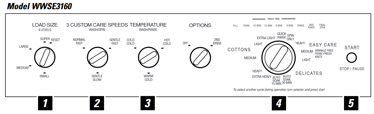

Jerome, I remember your model WWSE3160aoww. 30 minute auto soak is a nice feature! I've never asked, how did the washer proceed? Did it drain and spin before going into heavy or did it just go into heavy wash agitation after the soak period?
