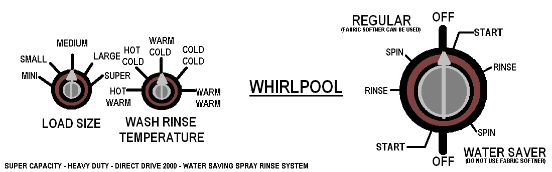

In this particular concept model, no. All 3 cycles come with with a spray rinse only. However, there would be other models where some or all the cycles offer a deep rinse.
The beauty here is that you have two options to remedy this.
First all these various models would have a molex connector separating the top and standardized bottom half of the wiring harness. If somehow you ended up with a spray rinse only washer on your property, you could order a complete control panel (that also comes with an upper harness) at a reasonable cost and just swap the whole control panel for a deep rinse version.

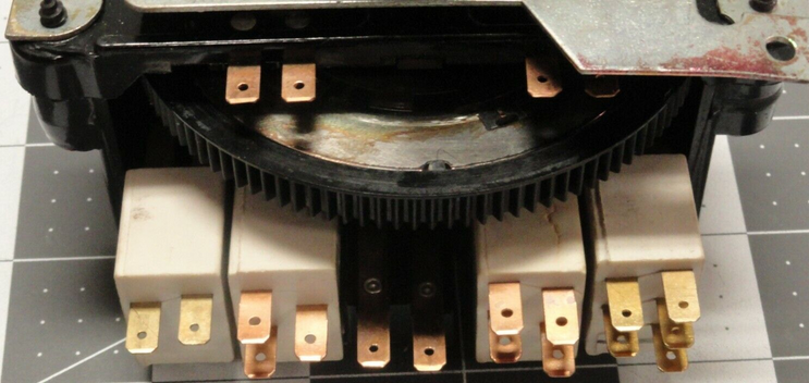

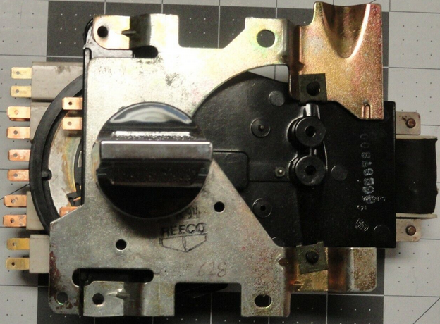

The other option would be just replace the timer with a deep rinse version. Contacts 0TM-12TM are standardized and would be physically interchangeable with about 14 other timers having the same contact sequence and position. Of these 14, two other versions which give deep rinsing would technically fit the fascia markings as well.
So transplants would be easy, and even the norm in service work.

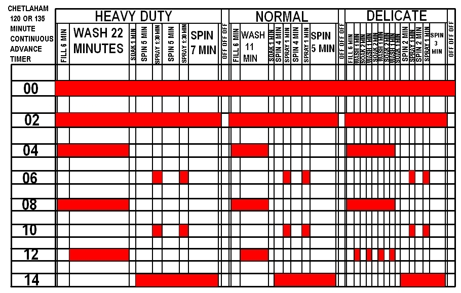

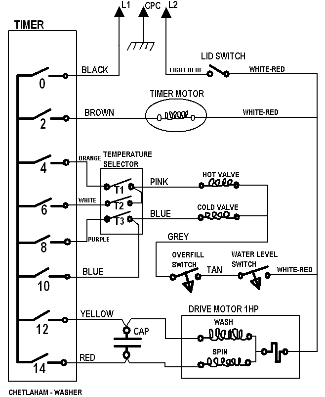

Agiflow, I went back to the drawing board and took your wish into account.
I added a regular cycle with a deep rinse and a generous 1 minute spray rinse to compliment that. I also sub-divided the sprays in the water saver cycle to better aid in detergent rinsing. Let me know if this is better, and what you would like to see offered.
Of note, I know that the wash fill periods are 6 minutes in duration, but in reality they would be around 4 minutes before the start of agitation. The timer typically lands about 2 minutes into the fill period from the lead in period to account for error and decal variants.

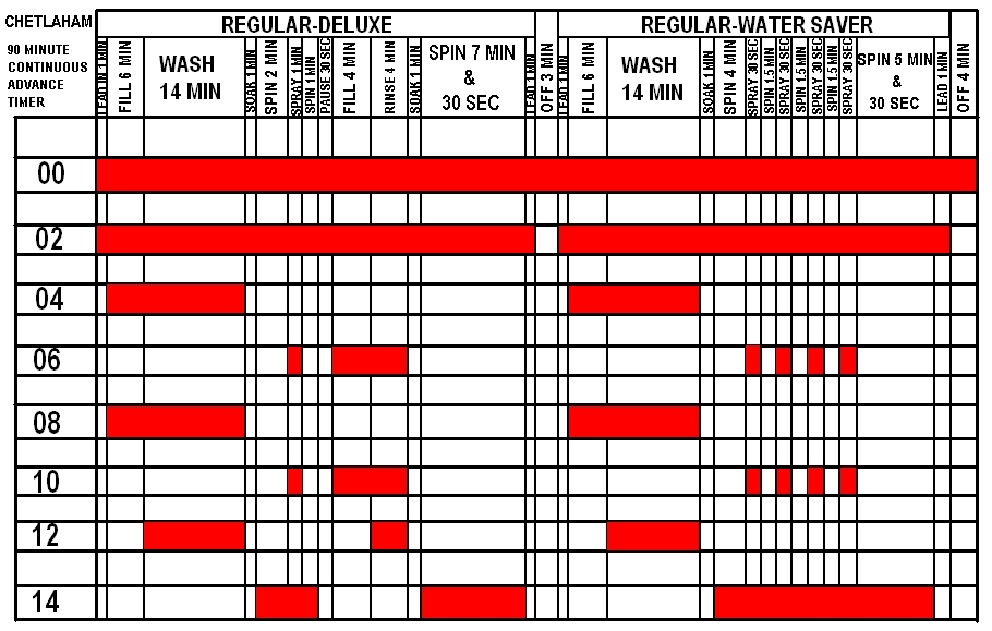

Jerome, what do you think about single cycle washers? A hearty deep rinse cycle fits nicely on a 48 increment, 7.5 degrees per step, incremental advance timer. Those are my favorite timers.
1 step equals 60 seconds in the following sequence.
1 step lead in
6 steps fill
14 steps wash
2 steps spin
1 step spray and spin
1 step spin
4 steps fill
4 steps deep rinse
8 steps spin
1 step timer lead out
6 steps timer off period
With the timer dial landing 3 steps from off when set to start the fill period before the wash is about 4 minutes. So the cycle time is 38 minutes total. There is no spray rinse after the final deep rinse so your softener stays put. Long wash for dirty clothes and a hearty final spin for big towel loads.
