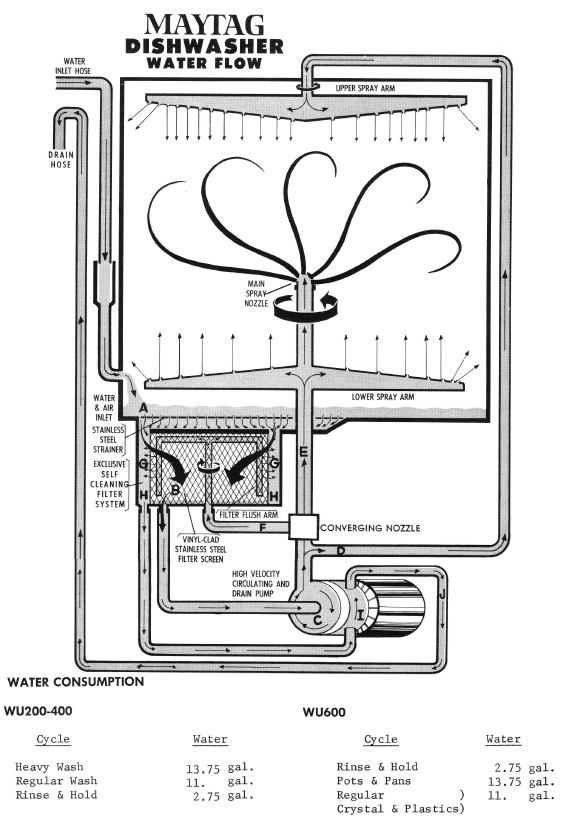

Weak? More like unrealistic. The water has to move, the water has to be filtered, the filter needs to be cleaned each wash arm sweep and the food bits need to be pulverized. 1/3 HP is just the starting point of realistic.  Many commercial dishwashers have motors just starting at 1HP.

Power Clean would be BOL, the Jacksons would be MOL and up in my world. Though being honest even the best Jacksons can not hold a candle to the Power Clean- they rely on heavily pre-rinsed dishes. A horizontal power clean system like the Maytag WU400 would take care of pre-risning but it <span style="text-decoration: underline;">still</span> would be no match for the Power Clean. Power Clean is the most effective, efficient and simple design compared to all other self cleaning fine filter mechanisms.
Maytag ditched the above for a vertical mechanism which reduces water carry over, reduces failure points, and increases soil removal. Whirlpool refined and perfected this concept even more when the final version of the Power Clean came out in IIRC in the 90s. The final PC version can out clean anything with only a few gallons of water. Tall tubs on the other hand, including the point voyager and any other dishwasher with a horizontal mechanism retain water which means more water changes per cycle- for a design that can not clean or handle food soils to begin with. Modern tall tubs use way more water than the PC design for what they actually accomplish.  Consumers did not win anything going to small pump horizontal designs.

Agreed with the above that the PC on Normal no options out cleaned my PV on Pots & Pans with HT and Sanitize. That would be with the Hydrosweep in the PC and lightening bolt arm in the PV. It also used less water on that program, and I guarantee less energy for water heating. The heated dry and motor consumption certainly were higher. The heated dry on my PV was anemic at best. I do wish they would have worked on the PC a little more like they did with the PV to create the newer lower consumption design with thinner and less wasteful spray arm design. Though, motor size likely would need reduced, which potentially would be detrimental. Even 0.2 gallons less per fill could have helped save it for a few more years. [this post was last edited: 5/22/2024-08:01]
