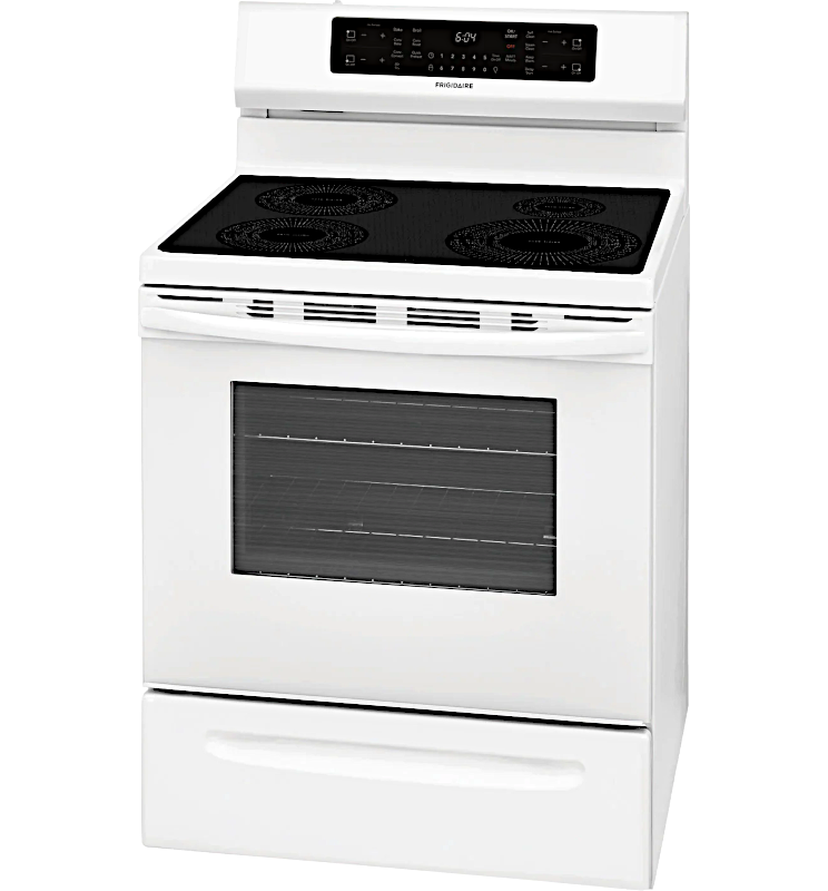

. . . is manufactures usually only have one model available and you can't get a white or all black model.
Mocked up a white one.  Stylistically, it works.  Emailed the suggestion to Frigidaire.  Now let's see if they use THEIR Frigidaire.
