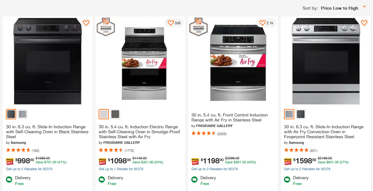

but I'm intrigued by induction.
Check this out
tempting.
But then I either have to replace my copper bottom Revereware OR
get a disk adapter.
The other thing is the wattage it states.  Is that, when it's in use, the EQUIVALENT of a traditional stove top element, or is that what it's actually using?
