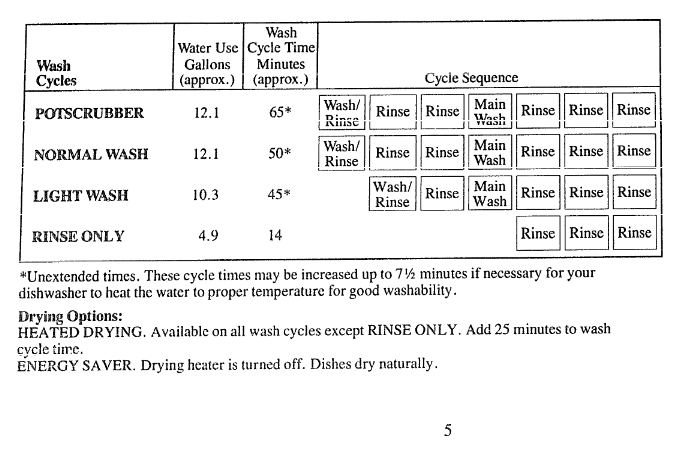

Chet, I did find a GSD1200L and a GSD1200M use & care manuals online kind of chopped up. :Both of these ended up chopping off the 3rd post-wash rinse where should have been put that extra rinse before the main wash. Both had the 11.9 gallon usage for PS/Normal and 8.9 for Light. On mine Normal & PS were Prewash, 2 rinses, Main Wash, and 3 post wash rinses--one of those post wash rinses had the "china crystal" fill level. Light Wash was Prewash, rinse, Main Wash, and 2 post wash rinses. Engergy Saver was like light wash, but the rinse after prewash wash a "china crystal" fill level and shortened main wash. China Crystal fill levels were shorter to achieve the "aerated" gentler wash action.
There was one of the GSD1200 versions where the main cycle buttons were Potscrubber, Heavy (Instead of Normal), Normal (Instead of Light), and Light (instead of Energy Saver).
The example sequence chart with the extended main wash & final rinse for Potscrubber may have been the very first GSD1200 when Debbie Reynolds did the print ads for that first model and it was designated as part of the PotScrubber III series.
I think in all the years I had the dishwasher, I used Normal once. The main wash length for both Normal and Light were the same due to water heating delay and I got the same cleaning results using Light with 2 less water changes. Only cycles I used regularly were PotScrubber, Light, and Energy Saver.
To me, those cycles should have been labeled Heavy, Normal, and Express Wash. [this post was last edited: 10/14/2023-15:52]

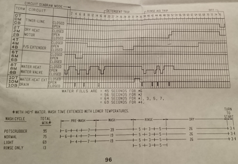

@appnut: 1987 would definitely put your machine in the major cycle redesign years at 7 fills total for normal and Potscrubber. One pre main wash fill would definitely have been reduced and most likely one post main wash rinse fill was also significantly reduced.
GE did this because I assume they discovered the two fill 3.8 gallon total rinse cycle implemented in the new Permatuff design was not enough to rinse away residue like GE had assumed. So to fix this GE took two seconds away from every fill and 10 seconds from one prewash fill to create a 1 gallon purge in the post main wash rinse cycle without significantly increasing total water usage. This appeared so rushed and sudden that GE actually forgot to change their new detergent and rinse aid release times on tech sheet following immediately after.

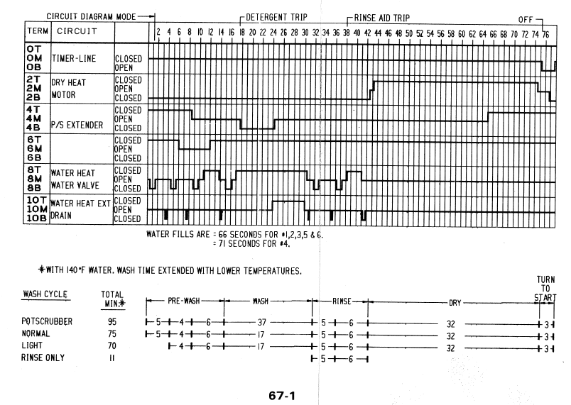

For example, GSD600D showing the correct detergent and rinse aid trip times (at 18 and 38 seconds) for a 6 fill cycle 11.4 gallon machine:

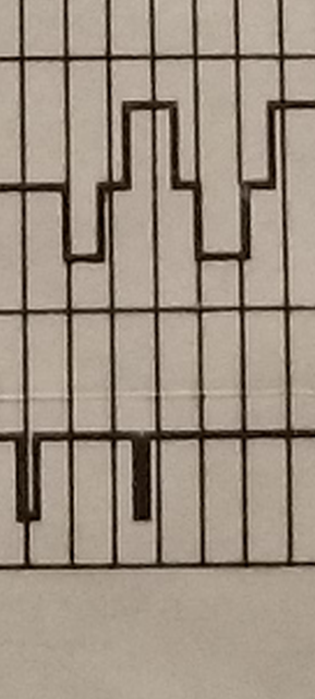

GSD600G 1987 12.1 gallon per cycle redesign showing the detergent and rinse aid times unchanged (18 and 38 seconds) even though these release times did not hold true in the real world.
In fact every tech sheet I saw printed right after the 86/87 cycle redesign regardless of model be it GSD500G, GSD600G, GSD940G, GSD1200 ect did not have their detergent and rinse times updated to reflect the new trip times. The trip cams however all had "7 fill cycle" embossed on them.
I'd give almost anything to know what took place in GE and what was discussed internally in the most granular detail- and why Hotpoint took a different approach from GE to remedy the inadequate final rinse issue. Video tapes and audio recordings of each phone call, room, booth, lab and work station would be epic- to be a fly on the wall so to speak lol. It would be a blockbuster series for me.
I mean, what technical detail was behind engaging the heater just 10 seconds away from the drain valve opening on a purge only to continue running said heater during the drain period and 30 seconds after? Why not have the purge right after the main wash? Or why do it X way? Just so fascinating to think about what was going through people's heads when they were creating all this stuff and the decisions they made.
