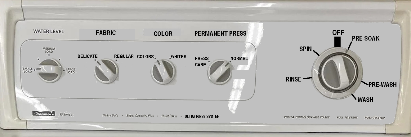

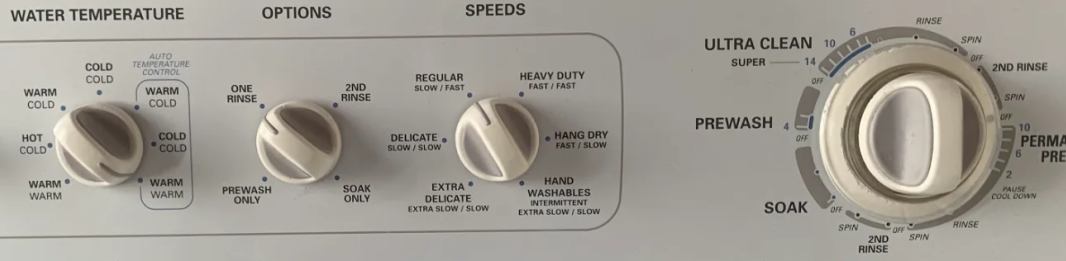

Pic 2, I have a 1999 Kenmore with separate stand-alone Prewash/drain/spin and Soak that agitates 4 (or 2) mins then stops leaving the tub filled for a soak for however long the user wishes (reset to a spin position when ready, then run a full cycle of choice).  I believe a few lower-end belt-drives in the 1960s and maybe into the early 70s had a Super Soak which did that in lieu of a Super Wash.

I've always been fascinated by all the offerings and variants Whirlpool had. IIRC, that Kenmore you pictured has the 16 min mark built into the wash which I prefer actually. Some versions of the Kenmores had an options knob which let the timer advance from soak into pre-wash and into wash if the user desired.

This is how I envision my perfect version of the Kenmore 90. Don't kink shame now ;)
Single cycle timer with no extra frills, pre-soak, prewash and main wash. Everything else is determined by the knobs.

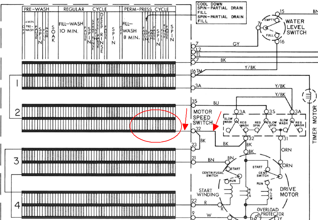

yes the spin on PP is fast
It does this on my harvest gold 806 and on my 606s
cannot change the speed it is programmed into the timer that way
Is it because knits have to be spun fast to get the water out
and a cache of dials to choose from
Reply #29
Hi Mark, I have a Maytag A806 which does the same thing. Believe that’s how they came from the factory, since it’s a shorter spin, is about equivalent to a slower spin speed.
The spin speed is directly controlled by the timer in the permanent press cycle. Contact two upper (3S) sends power to the speed selector switch in the normal cycle, however during the permanent press cool down, post wash permanent press spin and post rinse permanent press spin lower contact (32) sends power directly to the motor's high speed winding.
The times are very short, two and three minutes respectively. My guess is that Maytag didn't/couldn't add extra increments to the timer to account for the lowered speed, and technically they would need to add an over-ride contact anyway to prevent a user from inadvertently washing their wrinkle frees on a long high speed spin, so why not settle on what technically works?
Maytag washers were so gentle in general that IMO a 2 speed motor was just over-kill. Only thing I would have done differently was add a 20 minute+ wash like GE did to account for heavy soils.
Thanks for the explanations and wiring diagram. Good to know that my machine is working as intended.
