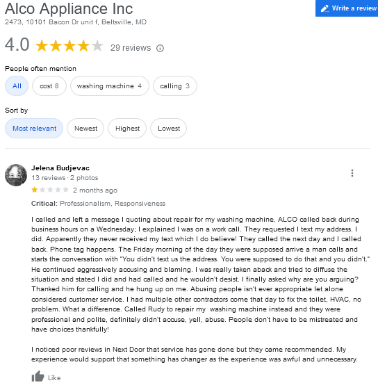

Funny you bring up me being mistreated. Have a look at (yet again) another Google review:
Slow down, listen and let people speak. Just because you read selectively (be it my posts on here or a someone's texts/email/letter) doesn't mean that holds true in reality.

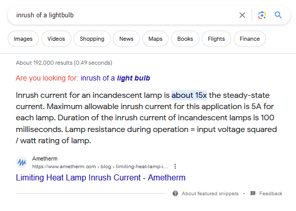

<blockquote>
"most electrical devices do not have a surge when they start lightbulbs, heating elements, etc. all draw less current the instant they start."
</blockquote>
<blockquote>
<span style="color: #ff9900;">"you just spew out misinformation from behind your computer"</span>
</blockquote>
A simple Google search literally says the opposite of what you said John, while vindicating what I said.
There is indeed a 15x surge of current according to Google.
Anyone can ohm out a cold 100 watt light bulb if they believe Google is inaccurate...
I normally don't address trivial semantics however I do not want other members to think I am spreading misinformation. That is not my the case. John you have a very power voice on here, many members take your word as incontestable truth, however this is not one of those cases.
