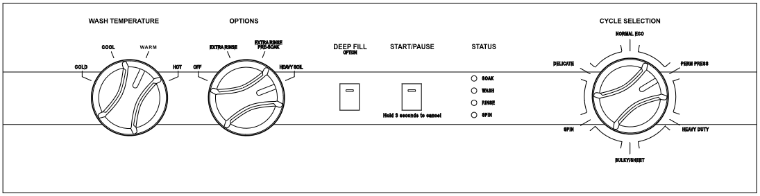

The TC5 guesses the amount of water per load, there is no variable user controlled pressure switch :
Whirlpool and others do this, they sense the load then add water for what the machine believes is correct for the clothes. Cycles like bulky can of course add some extra water to the final equation, and deep fill defaults to a full tub, however there can and are errors. A machine can not determine the right amount of water like a human can. A human can watch the machine fill, and set the pressure switch to the level that just covers the clothes. Overtime a user knows exactly at what point a pressure switch satisfy for a given setting, knowing where to set the dial based on where the clothes top out in the wash basket.
Load sensing is not 100% accurate or full proof. In fact it wastes water in Speed Queens case because there is a tendency to over fill to avoid the possibility of clothing damage from under filling.

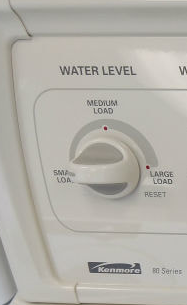

Right, but what if I wanted to wash a small load? What if I only wanted 5 or 6 gallons in a fill for a few hand towels? Or just a bunch of socks? 12.5 gallons is to much. In fact, as mentioned by Dadoes, the load will clump up and become unbalanced. A proper water level just covers the garments when lossley loaded.
My preference is a manual variable water level control that goes from 1/6th of a tub to a full tub.
Kenmore 80/90 series had the best IMO.
There's no information stated anywhere that TC5 has auto-sensing.  The cycle matrix chart states that the various cycles fill to specific level in inches and gallons (presumably measured on an empty tub, not considering what clothing may absorb and displace in tub volume).
TC5003WN (models AWN632SP116CW01, AWN632SP116TW01, ZWN632SP116CW01) absolutely has a pressure switch per the parts diagram document that I have.  It's on the water valve mounting bracket, not in the console.  And of course, there a pressure tube from the tub to the switch.
