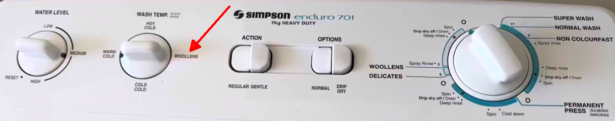

Woollens Cycle
Thanks to @spinspeed I found a video of this washer online. Does anyone know what the "woollens" does on the temperature selector switch? Is there an owners manual, service manual or tech sheet a member can link to?
