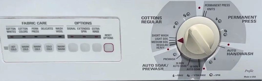

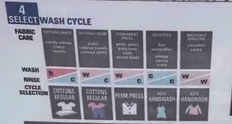

I found a GE washer where warm/warm is used in a woolens cycle. I always assumed wool was washed and rinsed in cold water.
"extremely sensitive to mechanical action when wet, so you should severely limit agitation to avoid felting. But it's not particularly heat sensitive and can be washed in warm water with no problem"

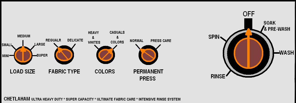

Personally I believe all washers should rinse with warm water by default except where cold is absolutely necessary such as delicate and wrinkle prone fabrics. As an example, the washer I am imagining only does cold rinsing when set to delicate or wrinkle free. Heavy & cottons is hot wash / warm rinse, casuals & colors is warm wash / warm rinse. Normal and regular provide a warm rinse. Press care gives a cold rinse but wash water can be either hot or warm as determined by the colors knob. Delicate on the fabric type knob overrides both the colors knob and permanent press knob defaulting to cold wash/cold rinse on all cycles. This washer does not have a woolens cycle.

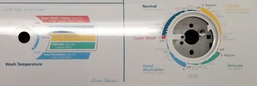

The cold ideology has also sadly spread to the wash. I notice in many vintage top loaders delicate and even knits recommends or is programmed for a warm wash.
For example, Whirlpool's cycle logic laundry system had delicate listed in warm.

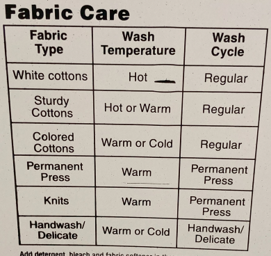

My Speed Queen fabric care chart recommends warm for knits, delicate and even handwash:
Today however all you hear on the internet is how all these items should be washed and rinsed in cold water, including colored cottons.
