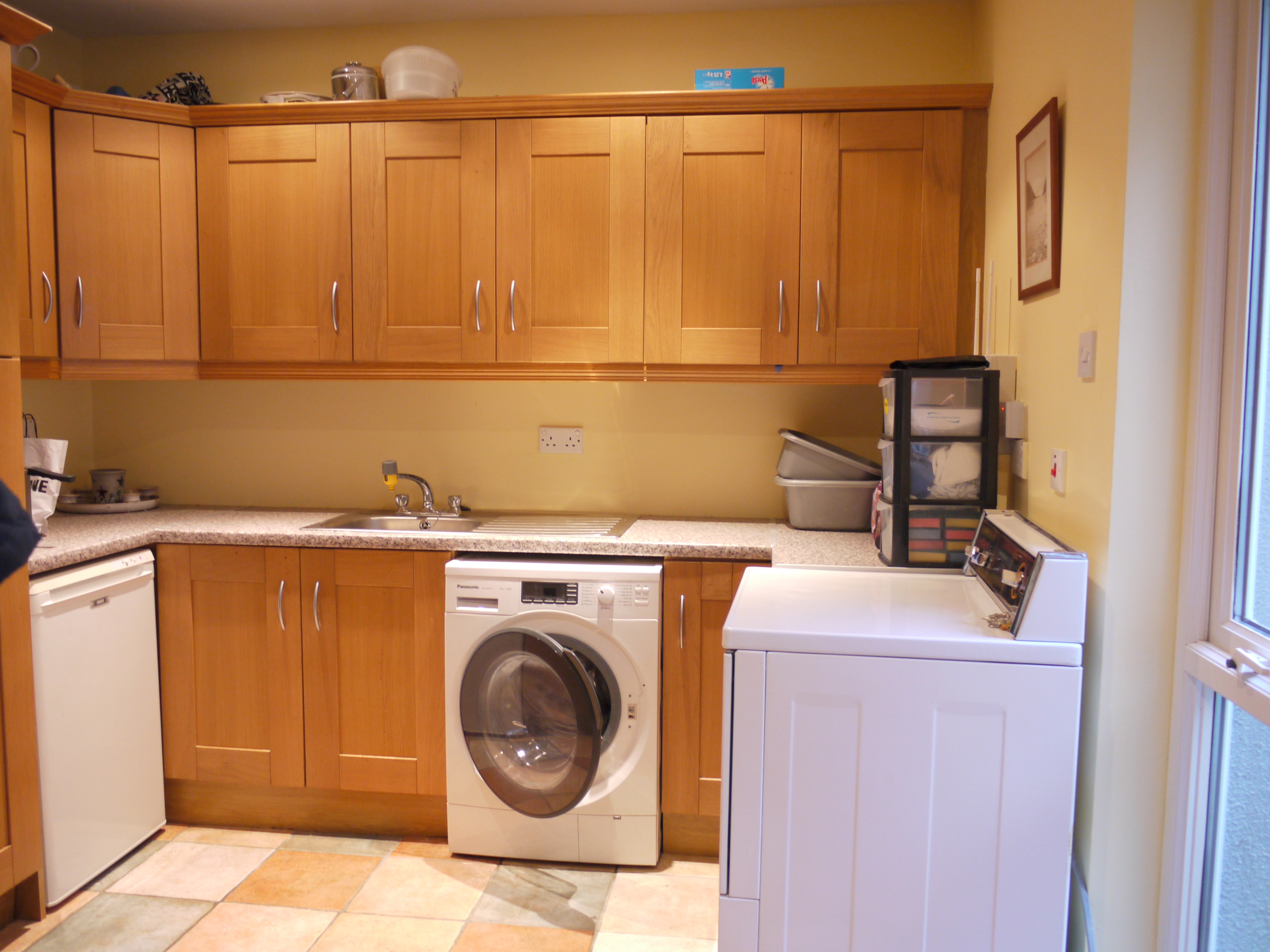

See what I mean about the odd combinations of US dryers and European washing machines you sometimes encounter here :

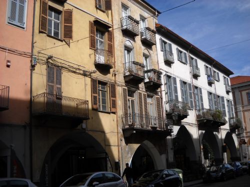

Or here,(downtown my town, wealthy folks living in historical downtown condo-like homes on the "corso")
http://www.alessandrianews.it/comuni/images/valenza.jpg
Or here:
http://www.targatocn.it/fileadmin/archivio/targatocn/immagini/Cuneo_comune/cuneo_via_roma.jpg
Which is where 70-80% of italians typically live...along with modern mid 70s modern condos (condos-boom) like this (wealthy-to mid class):
http://imagestc.trovacasa.net/annun...7358003/appartamento-in-vendita-a-valenza.jpg
Or newer...those have central hot water...(wealthy folks)
Newer condos like this typically now are quipped with individual water and heating gas heaters on the balcony:
http://cf.immobiliarebroker552.it/sites/default/files/40 particolare caldaia sul balcone.jpg
These ones are also used in cases like link 3,4 and 5 whenever the building went through some total internal re-modelling...otherwise what you find is point of use heater and central heating for radiators..if not gas heaters and not even radiators.
Historical antique fancy buildings like this one in the Corso downtown Milan probably are the kind of condo-like that went through constant total remodeling in early days and even though old you may have had developpd an earlier central water system...or individual...rare, but as you can tell this is for wealthy folks...
