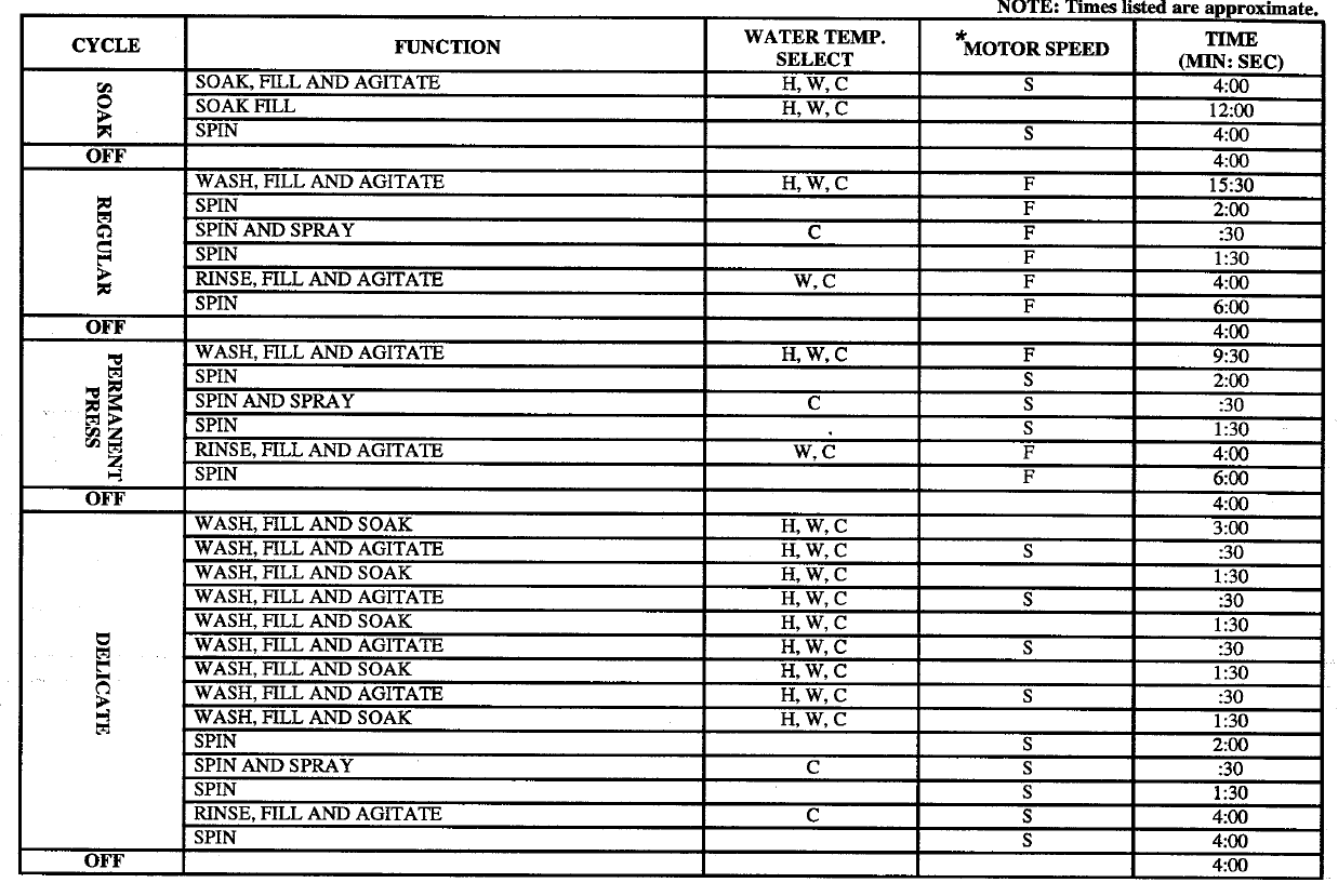

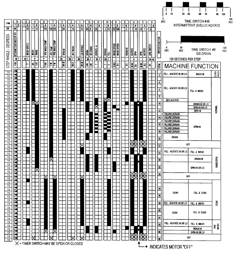

Here are the original cycle diagrams from a 1998 Amana service manual depicting the same Amanas that would become the AWN series in latter years. Except for the addition of the motor start capacitor and the AWN542 being changed out from a 3 speed to a 2 speed motor the cycles, timers, and wiring are all identical.
"B" is the closing of the spray rinse contact. Note position in the cycle schematic.

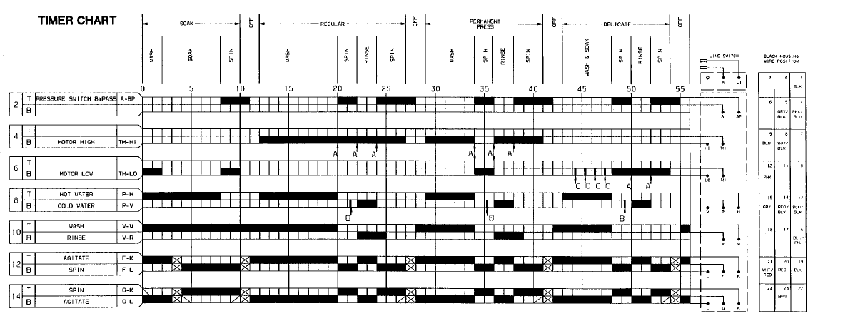

Future AWN311, 1 minute 30 second timer increments:

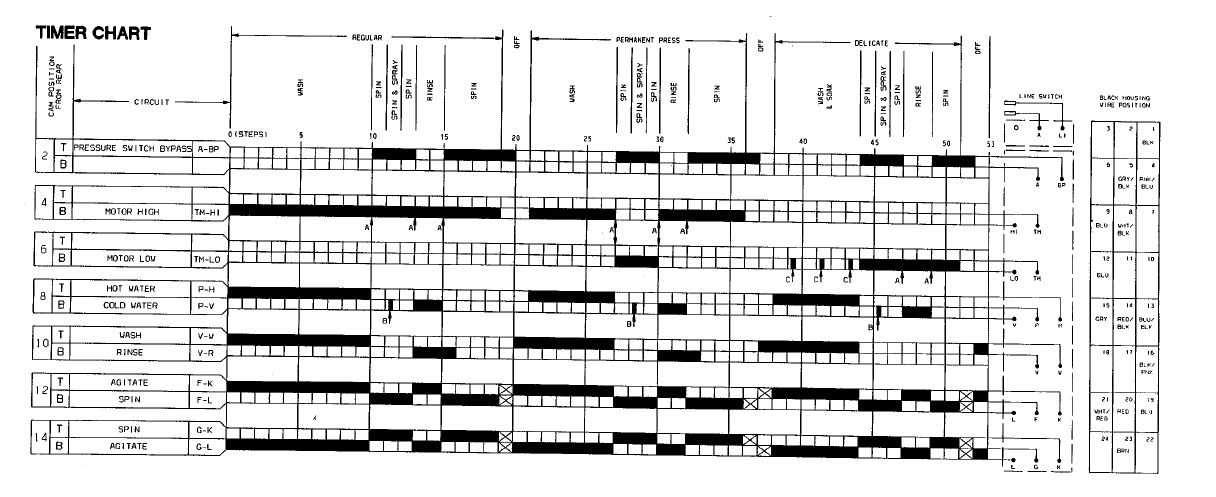

Future AWN412, 2 minute timer increments:
Future AWN432, 3 minute timer increments:

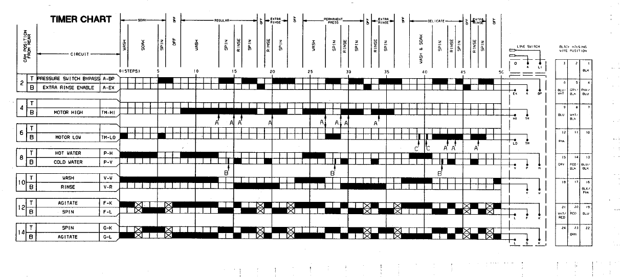

Future AWN542, 3 minute timer increments:
If we take a look at the listed cycle timing in the service manual the intent is the same- as to start the spray <span style="text-decoration: underline;">AFTER</span> the first spin increment is complete.
Future AWN 412:
Future AWN542:
 Amanas original intent was spelled out clearly, have the spray rinse begin more than 2 to 3 minutes after the tub started draining by then where all the water would have left the machine.
Alliance Speed Queen decided to shift the spray to the first timer increment covertly behind company doors, and have it start about 1 minute into the first increment which was NEVER the original intent of Amana or Raytheon. This timer engineering was completely unnecessary and counter productive. If everyone was like me, Alliance would be sending customers new timers with the spray starting where intended.

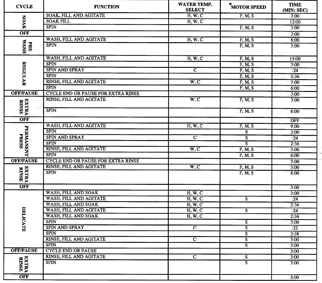

After re-consulting the timer matrix on my machine (LWN432SP115TW01) slow speed spin only occurs after the initial wash event, with spray rinse occurring 2 minutes thereafter.
After the initial rinse event has completed, the unit spins @ high speed, even if the extra rinse option is selected.
Some have questioned why Alliance Industries lopped the heavy-duty/permanent cycle into one, my guess is that the feds require any cycle named "Normal" must meet their standards for energy and water conservation, hence the rinse function being accomplished my merely injecting water as the machine is spinning after the wash event as the "normal/eco" cycle dictates.

You are correct, the spin after the main wash is done at low speed when the PP/HD cycle is selected.
It isn't until the final rinse when the spin is done at high speed, whether or not an extra rinse is selected.
I fail to understand why an initial low speed spin would be an issue for some, when in the end, the machine will spin at high speed anyway.
Lower spin speed means less water extraction resulting in more soap residue carry-over into the rinse water causing poorer rinsing results overall. Whirlpool's Resource Saver washer actually defaulted to high speed spin during the spray/rinse/recirculate mode whereas Speed Queen uses a low speed spin even in eco spray rinse.
