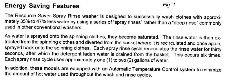

What is interesting, Whirlpool resource saver spray rinse service manual says that each recirculation spray uses one to two gallons of water. There were six recirculation rinses on the original resource savers.
Whirlpool Resource saver uses between 6 and 12 gallons of water, and adjusts for the amount of clothing in the basket.
