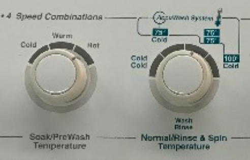

That hot setting on the resource savers was only there in case the consumer needed a hot wash. It was a workaround you filled it on the pre-soak cycle and then moved it over to the main cycle. It was never intended to be the main soaking choice to soak things in hot water.
John L
Then why didn't they put it on the wash/rinse &spin temprature knob?
They put it on the soak/pre-wash knob.
It is funny, because had I drawn up this exact control panel before Whirlpool did your reply would be "Chet, absolutely nobody soaks in hot water. That is pretty obvious. Hot water is for washing only. This shows you've never done a single load of laundry before, lulz"
 My guess is that Whirlpool thinks a hot pre-wash (and not a soak) is beneficial, when it is needed.
<blockquote>Then why didn't they put it on the wash/rinse &spin temprature knob?</blockquote> Perhaps for energy rating qualifications, which are based on the designated Normal cycle?
Standard laundry practice advises PRE-soaking and/or PRE-washing should be at cold, cool, or warm temperature to avoid setting-in temperature-sensitive stains.  Some machine programming does break that rule, such as WP vintage models that have the Super Wash process, although Super Wash seems aimed moreso at heavy (DIRT) soil than stains (thus the pause for DIRT soil to settle for flushing via the partial drain).
I recall KM advised warm (or cold) for the separate Enzyme Soak cycle.  I imagine programmed/pushbutton LK models with automatic advance had a warm soak.  Can't say about 800 models with option of soak-to-wash, whether that option when selected overrides a hot wash temp choice into a warm soak, collectors with those machines can perhaps investigate the details.
This is yet another reason why I dislike energy regulations, they make everything more confusing and complicated. ATC hot (100*F) would make a lot more sense being reserved for the soak and prewash cycles but thanks to energy start its literally backwards. I like conventions that are which straight forward and decipherable at face value.
DaDoES, you have a point. I've read a lot of lid instructions and washer manuals that state soaking in hot can set certain stains. Whirlpool's super wash does most likely have dirt in mind vs stains, hence the short time and half tub drain.

Chet if I select Hot/Cold or Hot/Warm while using the soak&Wash feature on the 1974 Kenmore 70 it will do the presoak and prewash in cooler water and then change over to Hot when it fills for the 14 minute wash.
Neat! Is the wiring diagram still intact on the back access panel on your 1974 Kenmore 70?
If Whirlpool went through the trouble of configuring their machines to fill with warm water on pre-soak when set to hot/cold or hot/warm, then I definitely should not be soaking things in hot water.

Welp, you weren't kidding - your senses are not deceiving you. Rinse contact 12 is actually closed during the fill portions of the soak cycle. Meaning the cold valve will always be forced open when contact 10 (fill) or contact 13 (spray) closes regardless of where the temp switch is set or what other contacts are closed. Further, wash fill contact 17 is open during the soak fills so any hot/cold or warm/cold selections are defaulted to a cold fill. Whirlpool definitely (wittingly) wants either cold or warm water in the soak cycle and nothing else.
