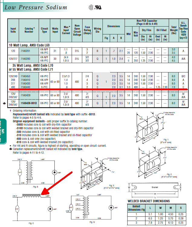

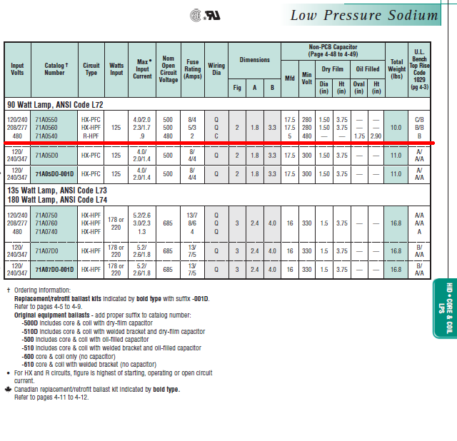

Most high wattage HPS,mercury,MH use actual transformers-the regulation is better and they are more efficient.Reactor ballasts are common for lamps running on 277 or 480V.Ballasts today are not oil filled-they are often potted in non flammable epoxy that is heat conductive.
Ceramic Metal Halides are another that can explode or rupture at EOL-but is extrremely rre-these also run off electronic square ballasts run at low frequency-120Hz.No flicker!I run CMH at home! Love their light-LED life can be unpredictable esp when the LED elements are driven hard to get quality light.This also can make their driver-ballasst run hot.
<blockquote>
</blockquote>
Yup! But don't forget residential street lighting. 35-150 watt HPS lamps are typically 120 volt reactor driven.
I've always admired the size and cost difference between reactors and other types.
100 watt HPS Reactor ballast in Cobra:
https://www.ebay.com/itm/3146921043...nRmn4bl6cyN4bIOck%3D|ampid:PL_CLK|clp:2047675
vs
100 watt HPS Multi Tap CWA ballast in a Cobra:
https://www.ebay.com/itm/3146787524...uiMciurDYSa95g%3D%3D|ampid:PL_CLK|clp:2047675
