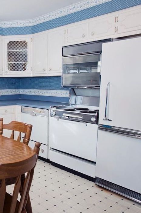

Part of the haul of vintage appliances from Newport, R.I. . Thanks to Jeannine (spacepig) for posting the ad, John (combo52) for letting me know, and a huge thank you to Scott (searsbest) for helping move and load those heavy appliances.
This is a General Electric Model TCF19DBC Serial # LB631067, If I am reading the code correctly, it was manufactured on January, 1969. As stated before, it is in remarkable condition for it's age. I was so impressed that I decided to replace my current G.E. Frost Guard with this one. The following are pictures taken in Brooklyn.

However, there is bad news. It doesn't work. Yup, from one bad G.E. to another. So here are the symptoms:
1) It lights up, fan in the refrigerator compartment goes on.
2) Fan in freezer compartment does not turn on.
3) Condenser fan does not turn on.
4) Compressor does not start.
5) Refrigerator compartment starts to get hot (sound familiar?). Like stuck on the defrost cycle.
6) Amp draw is 0.737

Louis, the fridge looks great, but I'm so disappointed to hear that it doesn't seem to be working!
It sounds as if there may be a couple of issues from what you are describing. Perhaps the defrost timer is stuck and forcing the system into a permanent-defrost cycle. There may be a way to manually advance it out of defrost mode.
There may also be an issue with a starting/running relay - I gave up too quickly on a really old Westinghouse fridge that wouldn't cool and it turned out to be a bad relay. I wish I knew more and could offer better suggestions, but I'm rooting for you! It's a beauty of a fridge for sure. Betty Draper would be proud.... LOL

Hey, it sounds like it's stuck in Defrost. If the compressor was bad, it would almost always do one of two things... A; click off and on with the overload. This would cause periodic dimming of the lights and clicking and humming off and on.
Or, it would actually run, and make a motor running sound without actually cooling.
For it to do "nothing" it's almost certainly an electrical problem in the fridge. I know that John (combo52) is much more well-versed in these than I am; but if I remember from reading his posts, the freezer fan stopping is a sigh of Defrost mode being active. If it didn't ever cycle on, then the timer may be stuck.

John (and Paul) were thinking the same thing...perhaps it is stuck on defrost mode. I'm going to attempt to advance the timer 1/8. It's located in the freezer compartment. If it's still a no go, the relay may be the culprit. I am hopeful.
Tiny update...
When freezer temp control is on and you hold in the door switch, you can hear a whine. But condenser fan, the compressor and freezer fan remain non operational. I'm waiting for the pain killers to kick in so I can get on my back and advance the defrost timer.
The defrost timer moves freely, and I can hear it working. I advanced it, no change.
The freezer fan is toast. It has seized, can barely turn it, it's also seems to have broken loose from it's mounting.

John (combo52) suggested to lubricate the shaft with Turbine oil.
