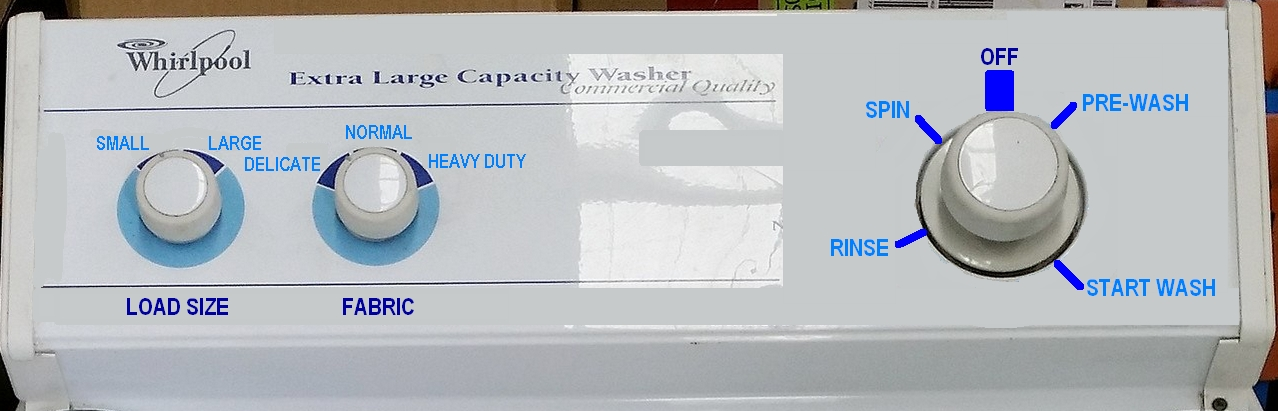

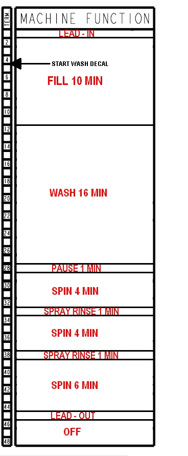

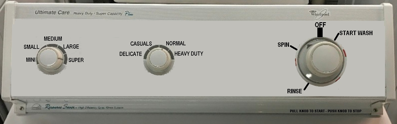

My issue with the VMW is that it exists as a full size washer in the first place. VMW came from a compact model you rolled around to this sink and was technically not intended to be ever adapted to a full size machine. But Whirlpool shamelessly did. That is all you need to know. Of course you're going to have problems. Thats like sticking a 1 HP motor where you actually need a 5 HP motor. Parts are pushed beyond their limits are destined to fail. It is common sense.
Want my honest opinion? Bring back the direct drives in the most brutal, shameless, unapologetically simple no nonsense way possible. That is what the world really wants and needs. Precision built quality, all commercial components, in the most straightforward implementation.
I've already have ideas in mind and I don't care if I offend anyone showing them off.

Pat, the only real solution is for Whirlpool to set up brand new tooling, molding, manufacturing and bring back the direct drives. Re-engineered with parts that last. Offer BOL all the way up to TOL versions. It will give people exactly what they're are looking for.
