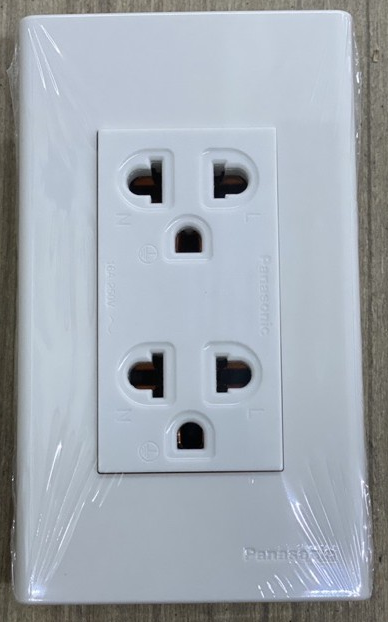

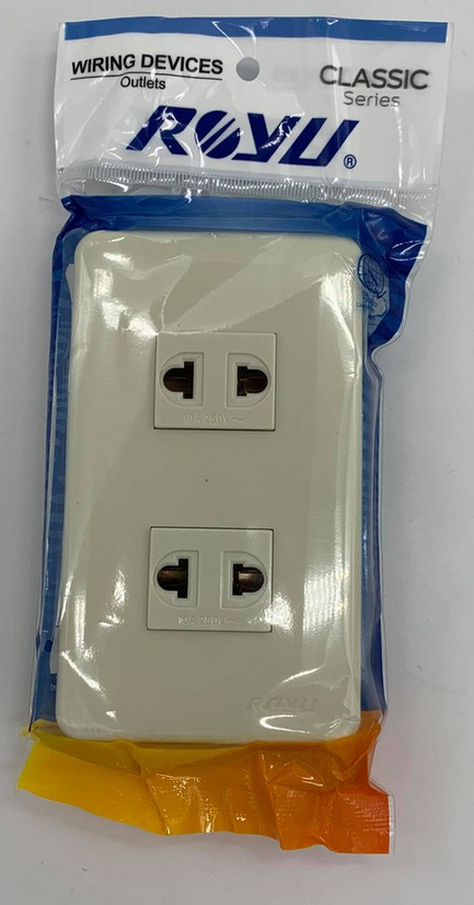

My Second Favorite Plug
Is the version of the NEMA 1-15 without the holes and slightly beefier solid blades. Typically reserved for 220-240 volts and used in China, Thailand and other Asian countries.
Because Asian countries end up with Euro plug appliances from Europe and NEMA 1-15 imitations from China, outlets both grounding and non grounding are designed to take the Type A and C plug and can technically take others like the type F even though type F will be left without its earth connection.
Thailand takes it a step further and has their own plug type "O" plug which is a hybrid of the US NEMA 5-15 but the the round pins and spacing of the Euro plug.
Lots of fun to be had!
