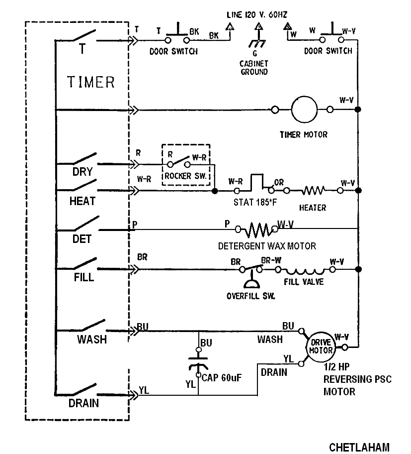

Anyway, yes, the Heavy wash on this dishwasher does indeed use 13.2 gallons of water per cycle. The timer can be started in 3 places:
Heavy- 13.2 Gallons
Medium - 11 Gallons
Light - 8.8 Gallons
None of these cycles waste water or electricity- on the contrary they save order of magnitude more water and electricty as there is no need to manually pre-rinse, prewash, soak, scrub, use the rinse and hold cycle, afresh cycle or the need to clean the machines filter. All that is taken and done by the machine.

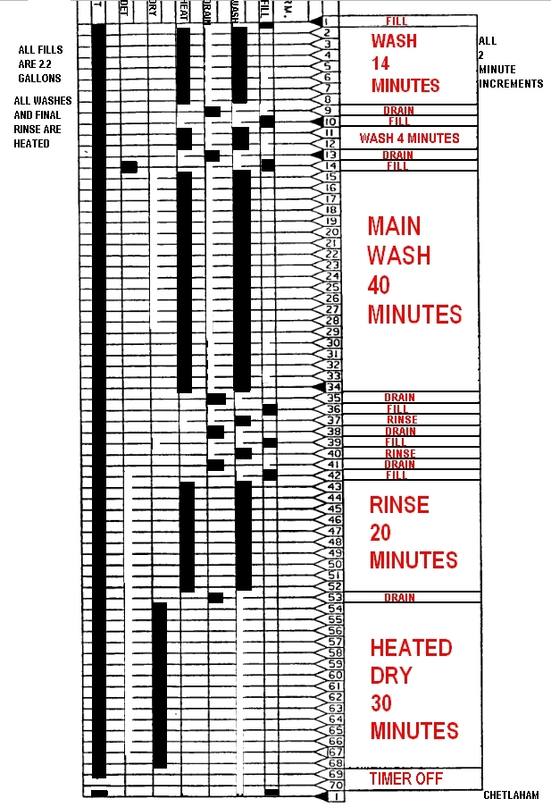

I've got 3 BOL cycle sequences that use only 8.8 gallons of water- however unless you pre-rinse your dishes well I highly doubt you'd want to use any of these three cycles or have the same water going around for 30+ minutes even though you would probably still get good results with the Power Clean Filter Module. IMO you need extra water for pre-washing and pre-rinsing excessive soils associated with dishware that has not been pre-rinsed.
Variant one, long heated rinse for best drying-
Variant two, shortened rinse-
Variant three, long main wash for baked on soils, no time given for building thermal inertia in the rinse, heated dry increased by 6 minutes to compensate-

Alright Dan, now you've done it. 30 minute heated rinse! I'm still including a dry, I like my dishware baked!
The thing is water coming already hot (+145*F) will trigger a short main wash (12 minutes) when the time needed to scour dish and bake-ware (30-40 minutes) would provide ample time to heat the water as it is.

I like GE's latter model Potscrubber water heating system the best. The timer runs continually through out the entire cycle, being at the top of the circuit switched by only one master timer contact (0M-0T) that does not open until the timer advance out of the dry period. Where a thermal hold would normally be present, GE uses a 29 minute delayed timer increment with a dedicated "Wet Heat" 4M-4T water heating contact. This contact is hard wired and can not be over-ridden, mimicking a forced thermal hold. If extra heat is desired to obtain water hotter than normal, achievable by selecting "Potscrubber" or "Water Heat", 10 minutes of heat is added around the delayed increment, in the first pre wash and in the final rinse for a true high temp wash experience. Depressing "Water Heat" closes push-button contacts 9-10 and 14-15 connecting the water heat light and supplementary 6M-6T "Heat Boost" contact to the heating element circuit. This illuminates the water heat light every time the heating element is energized letting the user know tub water is being heated much the same way some Whirlpool dishwashers illuminated a heating delay light when doing a thermal hold.
In any case all cycles have a long 40 or 43 minute main wash regardless of the incoming water temperature. Heating temperatures and cycles are achieved by the amount of time the heater is engaged in the cycle rather than the amount of time the timer is stalled. Just my preference.
