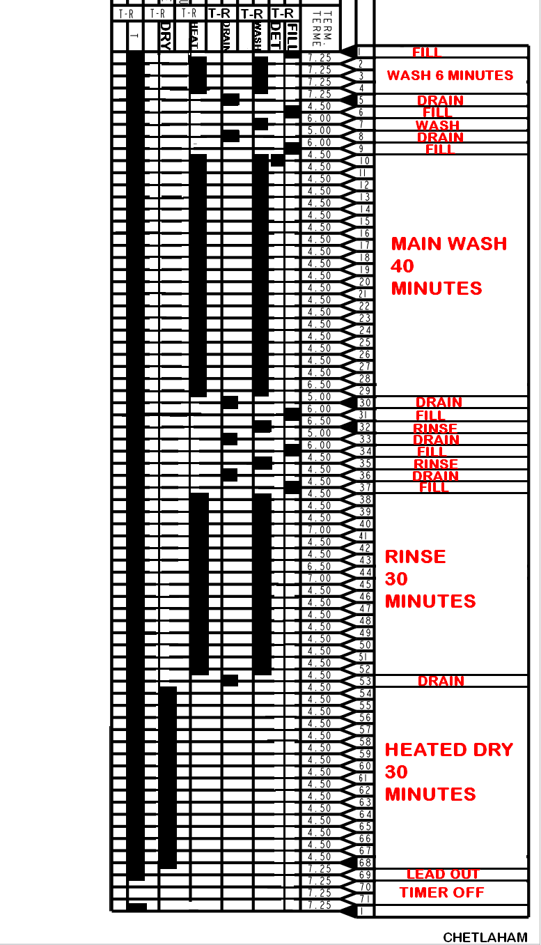

GE's Water Heating
I like GE's latter model Potscrubber water heating system the best. The timer runs continually through out the entire cycle, being at the top of the circuit switched by only one master timer contact (0M-0T) that does not open until the timer advance out of the dry period. Where a thermal hold would normally be present, GE uses a 29 minute delayed timer increment with a dedicated "Wet Heat" 4M-4T water heating contact. This contact is hard wired and can not be over-ridden, mimicking a forced thermal hold. If extra heat is desired to obtain water hotter than normal, achievable by selecting "Potscrubber" or "Water Heat", 10 minutes of heat is added around the delayed increment, in the first pre wash and in the final rinse for a true high temp wash experience. Depressing "Water Heat" closes push-button contacts 9-10 and 14-15 connecting the water heat light and supplementary 6M-6T "Heat Boost" contact to the heating element circuit. This illuminates the water heat light every time the heating element is energized letting the user know tub water is being heated much the same way some Whirlpool dishwashers illuminated a heating delay light when doing a thermal hold.
In any case all cycles have a long 40 or 43 minute main wash regardless of the incoming water temperature. Heating temperatures and cycles are achieved by the amount of time the heater is engaged in the cycle rather than the amount of time the timer is stalled. Just my preference.
