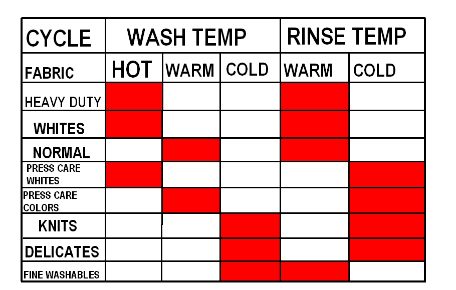

Dan, this is what I came up with. I'm debating on calling the cold/warm cycle "hang dry" Otherwise I am unsure what fabric works best with cold/warm.
The only fabric of which I'm aware that laundry doctrine calls for a warm rinse ... or whatever same temp as the wash ... is wool, to avoid shrinkage from thermal shock during (minimal) agitation.  My F&P machines run rinse at the same selected temp as wash (tap-cold, controlled cold, cool/warm- or warm, warm+ and hot are not available) on the designated Woolens cycle.  All other cycles are hard-coded for cold rinse.

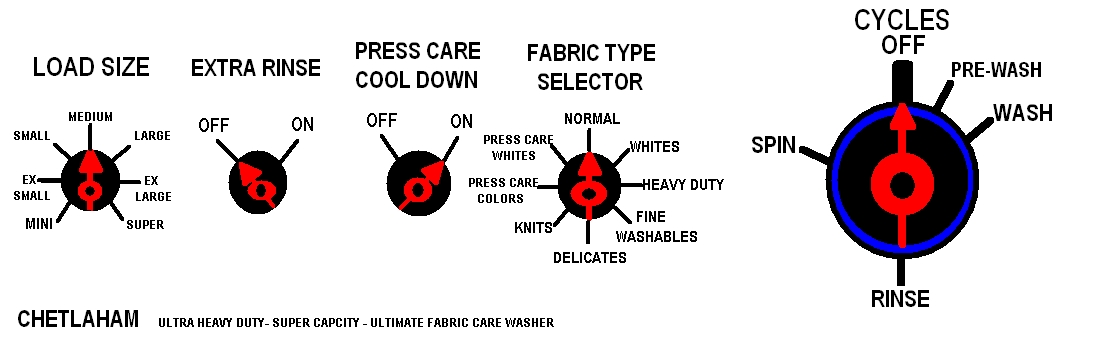

@agiflow- I should have included a cycle matrix and wiring sheet here but there is so much going on with the circuitry and cycle increments that following dozens of ever changing  nodes becomes exhaustively confusing.
To answer your question all of the 48 increments, 7.5 degree advancement, 60 seconds per step are fixed in time and duration. The wash period is always 14 minutes from start to end of agitation. The variables come from the "fabric type selector" switch which controls temperature, speed and duration of motor run.
For example, with the selector set to "Heavy Duty" the washer would fill with hot water, agitate on high for the full 14 minutes, and rinse in warm water. On "Delicate" the washer would fill with cold water, agitate 2 minutes on low, soak 4 minutes, agitate 2 minutes on low, soak 4 minutes, then agitate on low for 2 minutes before proceeding to drain and spin.
Time is tracked by watching the knob advance clockwise while into the cycle.
I prefer EM to electronics. You can get many different wash, time, speed, sequences, cycles and varying combinations on top of those by adding or deducting various timer contacts controlling the desired device. Think of Kenmore's (and commercial washers) greatest success beside the DA agitator.

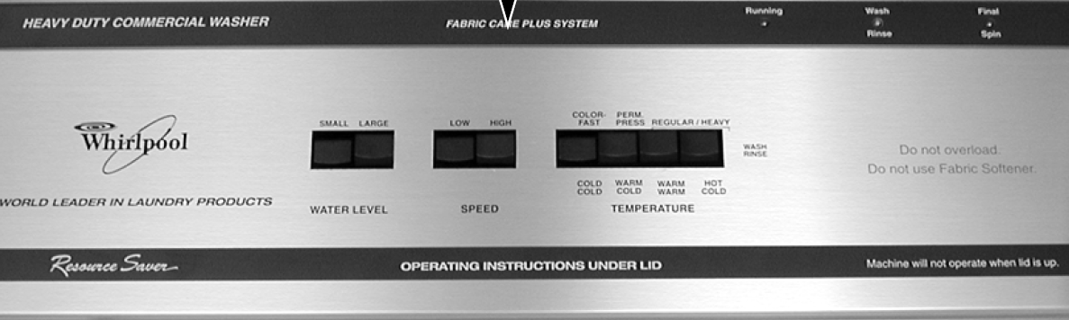

Whirlpool agrees to the merits, commercial resource saver washers use an ATC warm rinse on the regular cycle.

I expect ATC warm rinse on machines that offer it is not more than 70°F.  75°F is the target on a 1999 KM I have.  ATC cold wash is 70°F.  The two ATC choices with cold rinse have the rinse being tap-cold, not controlled.
A 2002/03 WP GSQ9669 has two AccuWash selections, neither states temps.  The feature info says Warm/Cold wash is 100°F, Cold/Cold wash 75°F ... so presumably rinse in both instances is tap-cold.
